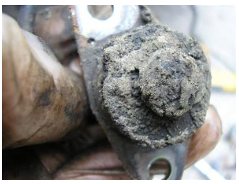

Yuck ... Look how dirty a wheel speed sensor can get.
Attached Thumbnails After New Tires Installed, ABS Light & DSC Fault Light On-dirty%2520speed%2520sensor.png

That's definitely not an XK8 wheel speed sensor. I'm assuming that's just a pic you found.
First, I'd make sure they put all of the tires back in the correct places. Your rims all look the same but the front ones are narrower than the rears and the front rims take a different size tire than the rears. If they put a rear tire on a front rim, or vice-versa, or if they put a rear tire/rim combo on the front by mistake, then the wheel speed sensors might be picking up enough of a difference in wheel speed to trigger the ABS/traction control message. Look to see if the tire on one wheel seems to bulge out more than it should while the tire on another rim almost seems too narrow. And just check the tire sizes to make sure the two fronts are the same size and the two rears are the same size.
Assuming all of that checks out, they might have just jiggled some dirt loose and the wheel speed sensors need cleaning. Someone posted a groovy video a while back which shows how to clean them. I think it's pretty simple. Look in the FAQs at the top of the forum. Clean the sensors, and if the problem doesn't go away, there's a chance they bumped one of the wires leading to a wheel speed sensor when they were installing your tires. That could have broken the connection within the wire harness, which would be almost impossible to see. If that's actually the problem then proving the tire place did it would be nearly impossible.

Naw, Reverend Sam, I didn't say it was a Jag sensor, just "a" sensor. That is extremely filthy regardless of the car.
I drove the car this morning and the warning lights were off. Maybe the tires needed time to adjust with the ABS.
