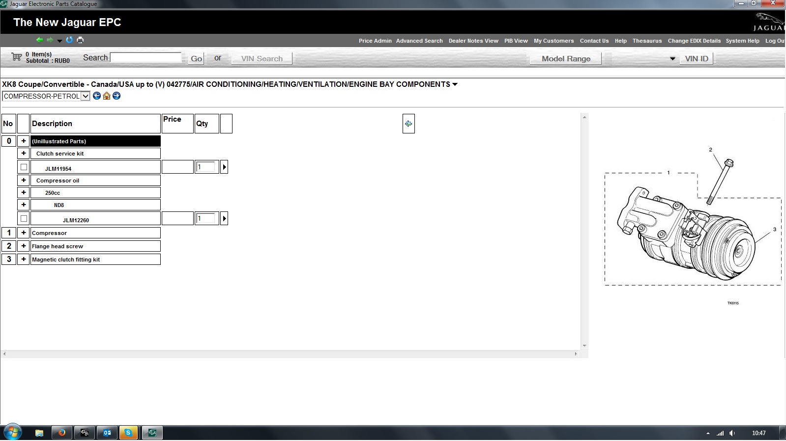

A Compressor Clutch service Kit and PAG Oil are available:
