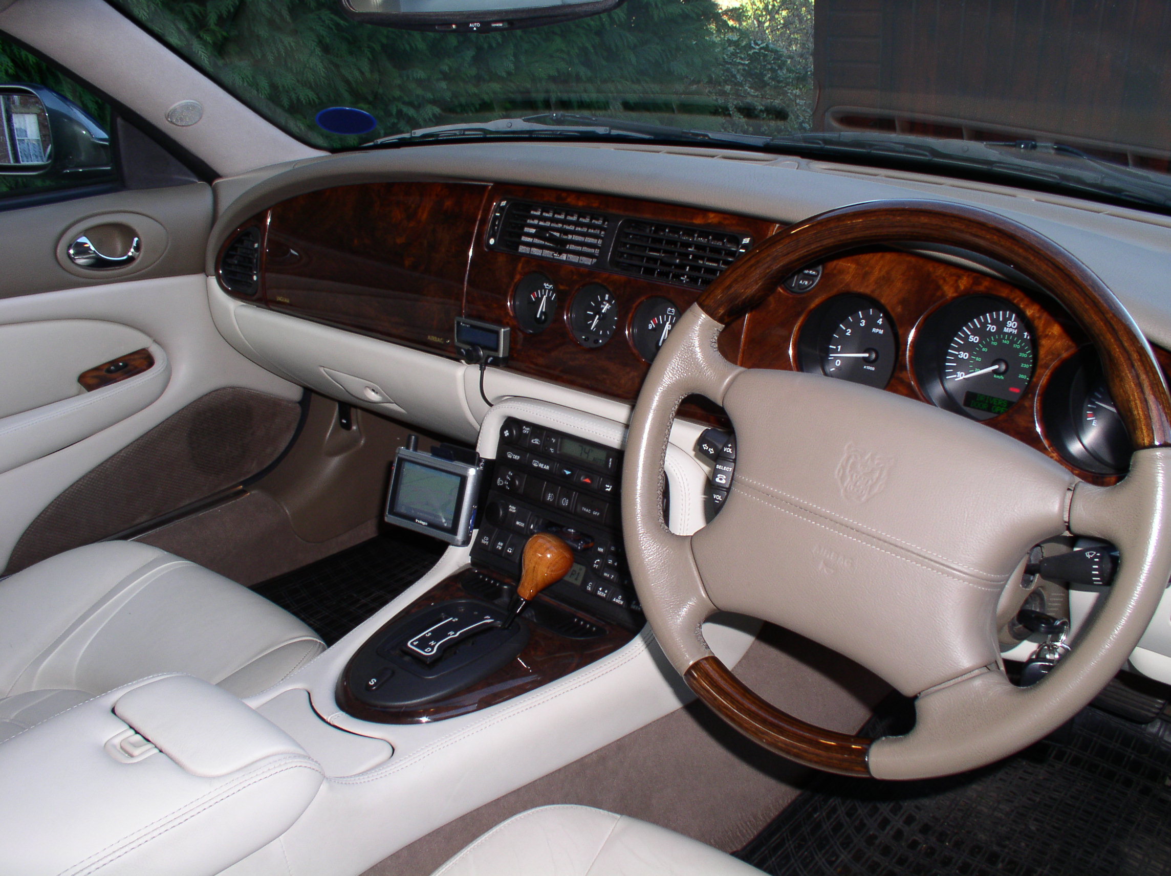

This one for the left side Centre Console which I used to mount my Indago:
This one for the RH Centre vent:
Easily fitted and no drilling required.
