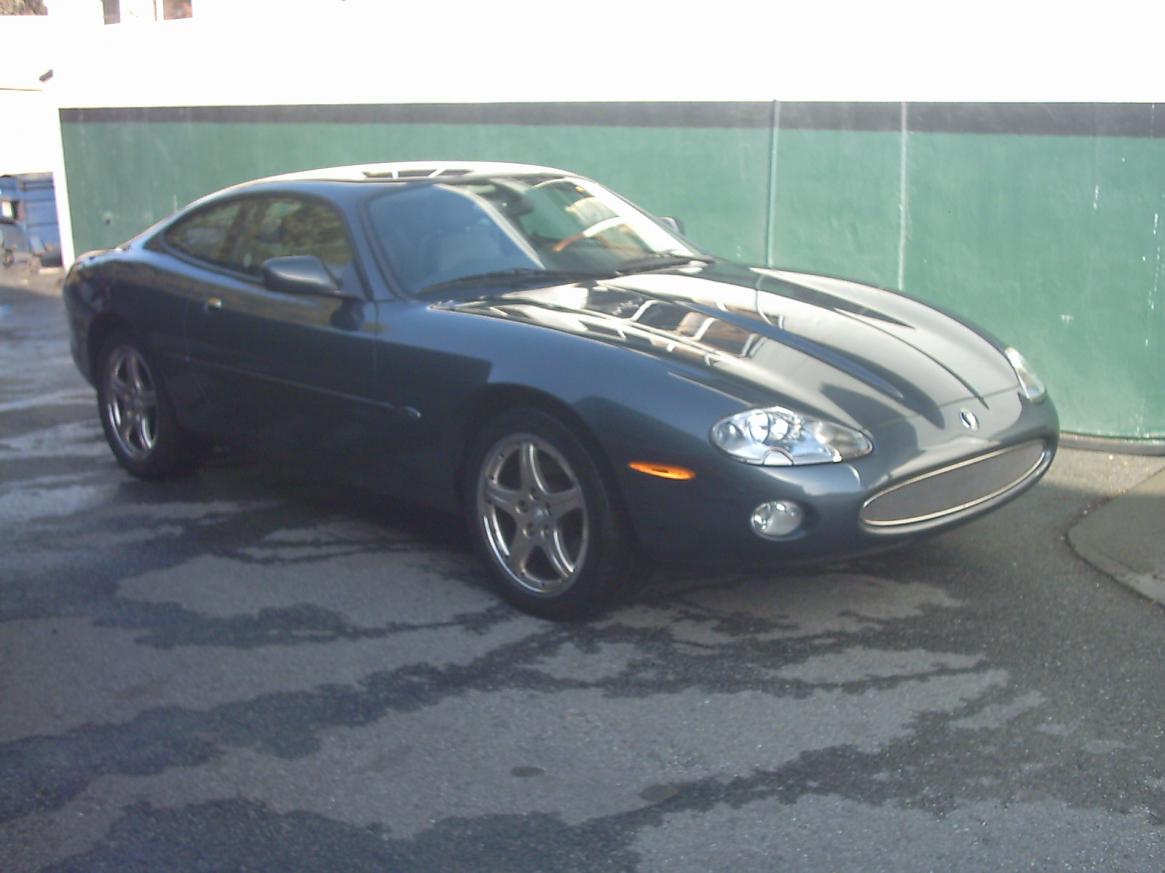

car is all together and running smooth as silk. 1 piston, 1 head, gaskets, hoses, etc. driving it locally to work out the bugs.
Attached Thumbnails AJ26/ AJ27 head casting question-018.jpg
