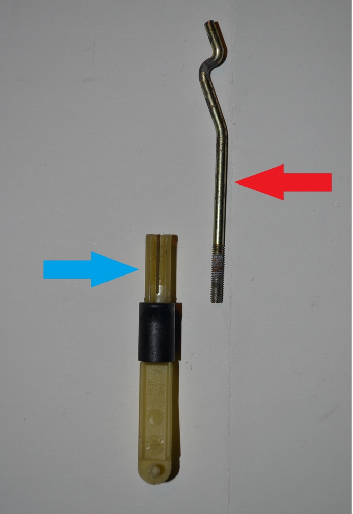

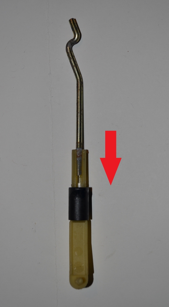

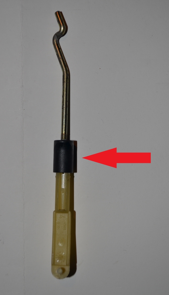

Note the error in Sam's video in the section on removing the latch link which is a good way to break it. This is the correct way to split the link:

I am about to remove my drivers door latch in order to replace the door ajar micro switch. I'm not sure that I understand the photos above. Is the procedure to :
Push the black collar downward and then apply sideways pressure to the the steel rod ?

..... Push the black collar downward and then apply sideways pressure to the the steel rod ?
CORRECT
The lower section stays on the door latch. Trying to pop it out of the latch arm as Rev Sam describes in the video is an almost certain way to break it.
