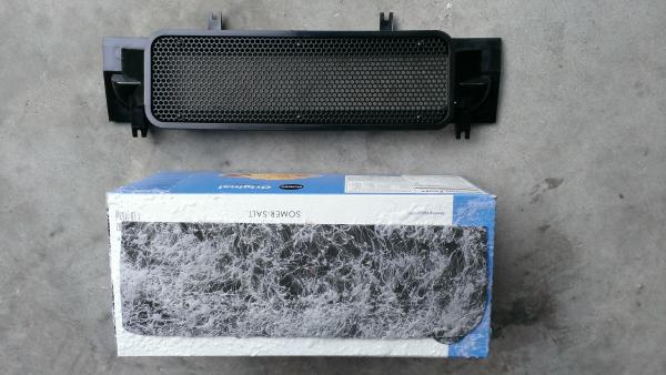

I noticed that one of the bulbs was out in the 3 gauge panel. So I popped off the trim to get at it and discovered...Yuck!

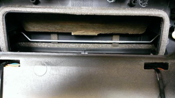

A LOT of soft foam rubber parts were falling apart in the air vents. Some of it was stuck in the grille, while a lot of it was ready to turn to goo the moment I touched it. It also smelled old and musty like it had been around for 10 years. Go figure.
This is what it looked like.
I got the gauges out of the way (so much for that bulb right now, this was serious!) and started pulling apart the air vent.
After I got the vent parts out of the way I could see that the deteriorating rubber was everywhere. You can see that there used to be a foam pad on the vent flap that was basically crumbled away.
So I cleaned all the parts and wiped down as much of the stuff in the dash as I could get to. Vacuumed out a lot of debris inside the dash and ducts.
Then I cut a new foam pad for the flap out of the leftover 2mm dense foam I used on the A pillar recovering. Sprayed adhesive on it so I could mount it to the flap.

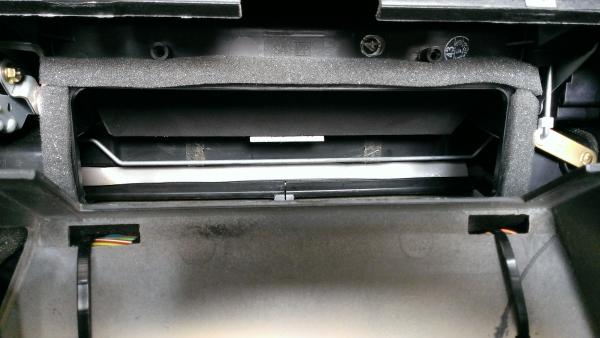

I installed new soft foam weatherstrip everywhere I removed it. Mounted the flap pad.

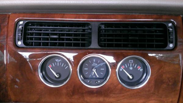

Finally, back to the gauges. I replaced the bulb and polished the clear plastic lenses with Meguiars liquid polishing compound (safe for plastics and clear coats). Then polished the trim panel up a bit.
Before I mounted it, I added some thick foam blocks to the empty areas around the inside of the panel to help deaden noise. I figured it never hurts to do it if you can.

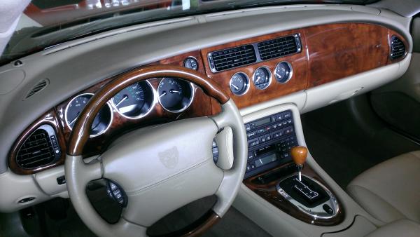

And now all back together. Busy evening's worth of work.

Today I pulled off the left and right air vents to give them the same rework as the center. I was surprised to see that neither one had the same crumbling foam as the center area. I gave'em a good vacuum and wipe down. Also polished the lenses on the gauge cluster along with the rest of the wood trim pieces.
I think I am done with the dash area at this point. Smells better already and I haven't even driven it yet.
Looks really good again too.
