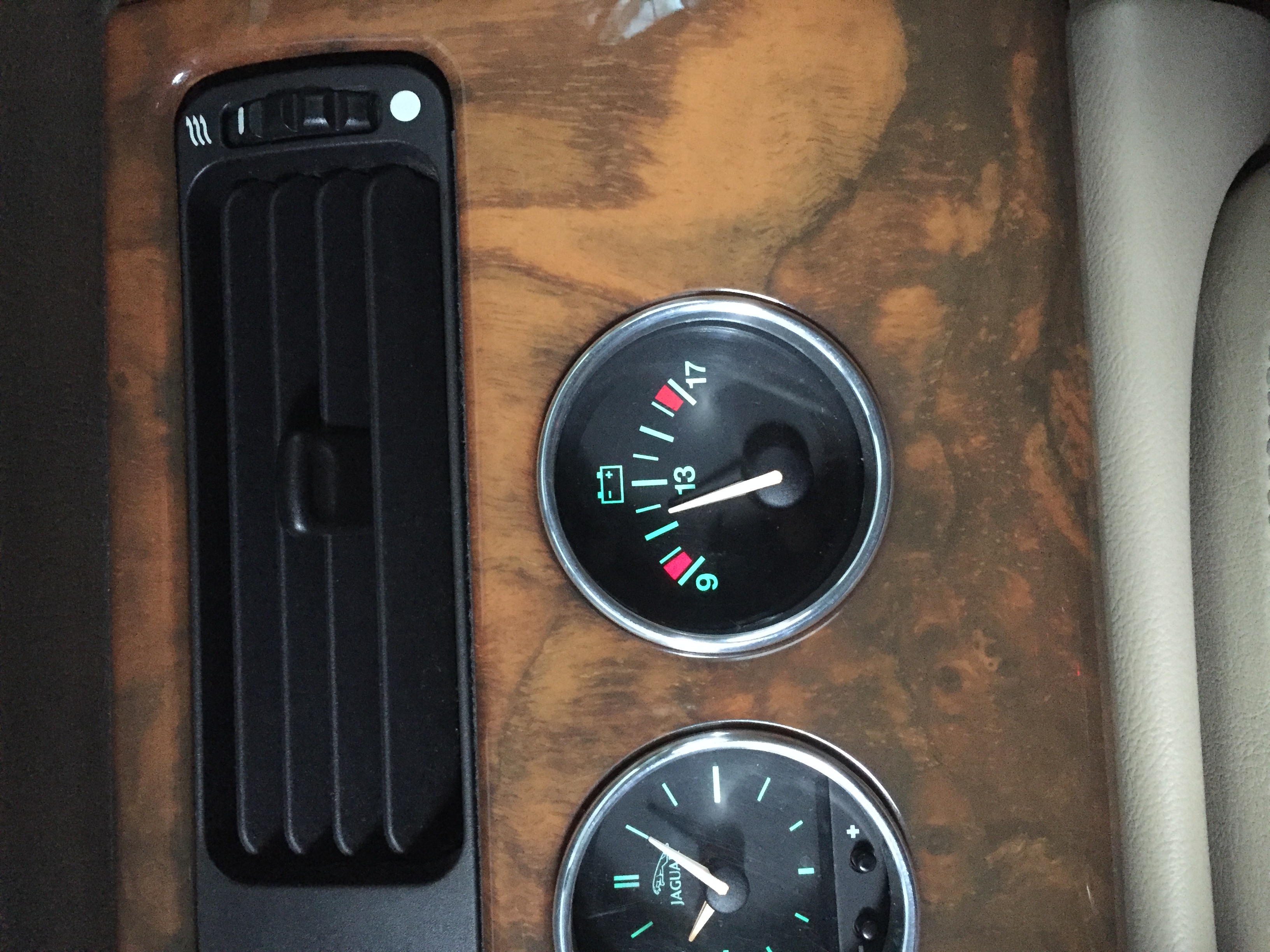

I have been having a few strange symptoms and need some help looking for the culprit. First, I started getting a whine from the engine compartment. Then the convertible top would stop working. You can hear the pump cycling but it seems not to have the power to open the top. After a few days of trying the top, sometimes the latch will let go and I have to help to top for the first foot or so, then it will open on it's own. When closing, it works fine but there doesn't seem to be enough power to close the latch. I have to do that manually.
I'm wondering if I may have a failing alternator. I took off the drive belt and started the engine. No whine. Since I have been doing a lot of work on the car, many of the parts are new.
I have replaced the water pump, Idler,tensioner and belt. The whine stays the same with ac on or off.
My voltmeter has at times been showing lower readings that I remember it doing. I seem to recall it was always center at 13. Now it shows lower than that at idle. I hooked up a multimeter to check the voltage. I was getting 12.4 with the engine off. Engine on and running around 1500rpm I got 13.4. If I let the engine idle I get around 12.20. Any thoughts?

I took your advice and went to Advance. They did a check and it seems there is a problem with the alternator. At idle with ac and headlights on the voltage went down to 11.80. I may send the alternator out to be rebuild.
