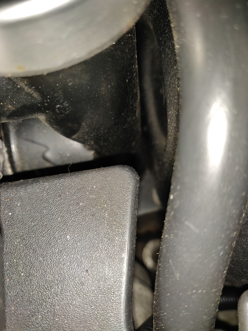

This one is so close I don't think the capwould clear the fuel crossover pipe which is about 16mm thick. I think I may just buy a dufferent kit from someone else. I've had this one laying about for a couple of years now. Its never been used so its still looking like new.

FWIW, this is mine. About 1/4" gap:
