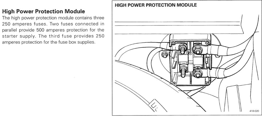

I agree with Dan you should check the fuse block in the trunk. The blocks have been known to crack and cause several no start and running failures where the car would just stop and not start for a few minutes. I am also thinking as I mentioned before this might be the cause of your other problem and not water in the gas.

A photo of the fuse
Attached Thumbnails Another Problem (It's not bad gas this time)-highpowerprotectionmodule.jpg

I'll definitely lift up the floor of the trunk tomorrow morning and see if that fuse block looks damaged in any way. I'll even tighten up the nuts a little.
