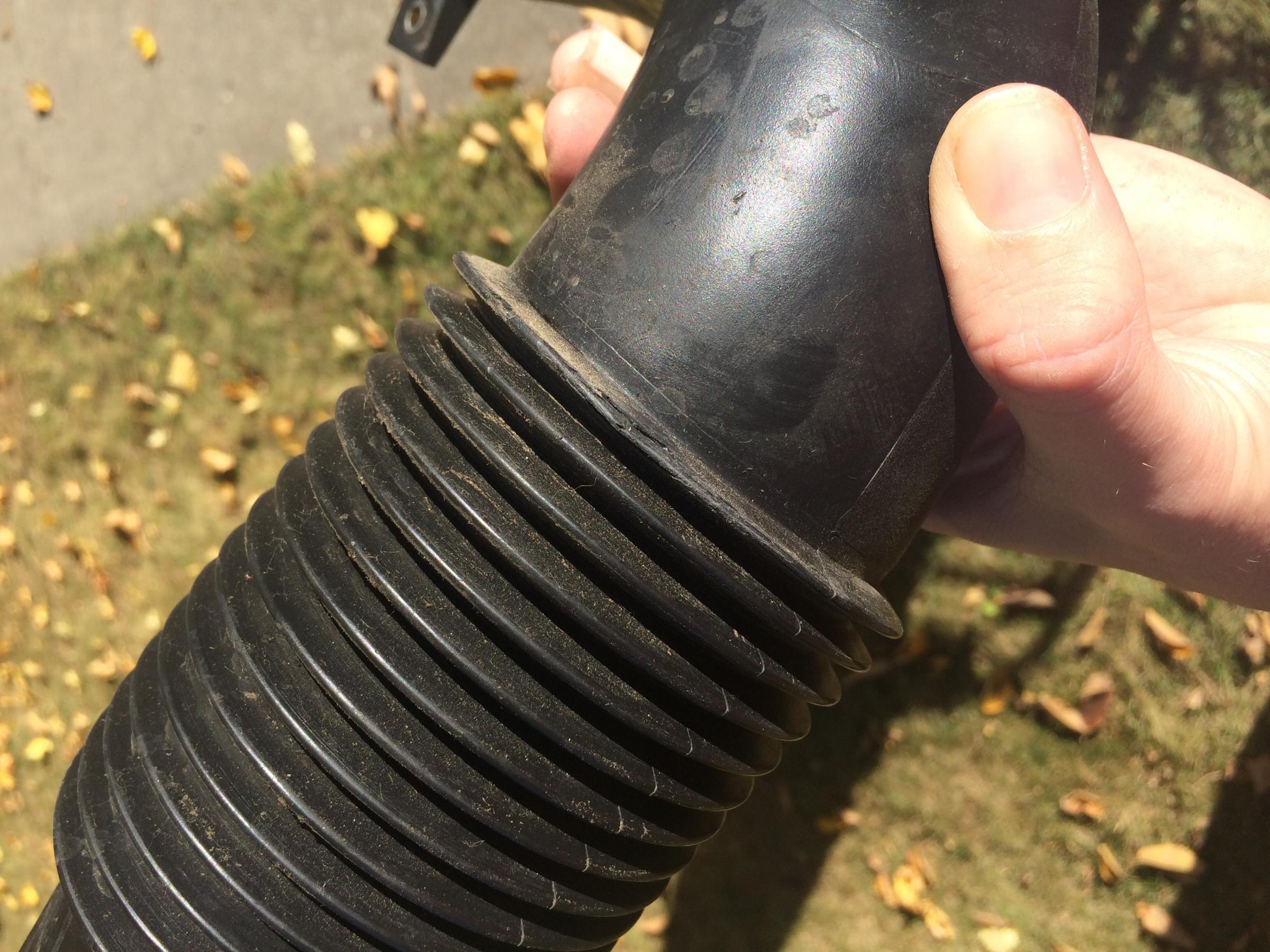

Well today I was chasing TPS issues and replaced the gold contacts (with no luck ) so I had the hold intake elbow off. I had looked over it before, but today I noticed one little bad spot. Could this be enough to cause issues? Right now the Restricted Performance takes a back seat to the failsafe engine, but it does make me curious.

Yes that little leak can really confuse things for sure....

Agreed. Any cracks in the accordion section of the intake air duct can cause havoc. Tape it up or replace it. I replaced ours in October 2012. No codes have been thrown since....

I patched the leaky intake hose with some blackjack [black roofing caulk I had sitting around] (there was just a pinhole through), cleaned the back side of the MAF (still looked clean to me) and replaced the air filter. So far, so good, but still too soon to tell.
