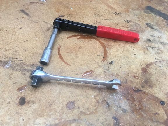

As a newbie, I watched all videos and read all I could about changing transmission fluid. My first oil change was not too great. First, I did not realize that I should also do the connector sleeve and replace the seals on the Mechatronics unit. Second, getting the darn oil fill plug back in after you reach the magic 40 deg. C proved not so easy. Burned my hands just about everywhere, and before I know it, I was way past the 40 deg.
I just did the second oil change and this time I was better prepared. Got all the seals for the Mechatronics and, most important, fabricated my own "fill plug tool".
I cut off a piece of 8 mm Allen wrench and epoxied it centered to a 8 mm ratchet wrench. Then I made a second ratchet wrench with a short extension. With the two sections put together and the fill plug at the end, the whole assembly just slips over the exhaust pipe and you have one ratchet hanging down on each side of the exhaust pipe.
You can now use either of the ratchets to align the plug and/or to crank it in and your hands never get close to that darn hot exhaust pipe. This can obviously not be used to break it loose or to tighten to final torque, but it is a great finger saver!

From: Townsend TN
Originally Posted by nalle
Mickey,
Great stuff, Nalle - thanks for the tip! You wanna loan those out?

That custom-made tool is indeed a great solution. Should be quicker and much easier on your hands around the exhaust pipe....

I tried the "wet towel" solution before I made my tool. I felt that the towel just blocked my view and made a tight space even tighter. Now I just put the two ratchet pieces together with the fill plug on the end. I slip the whole unit over the pipe from the outside until the inside ratchet hangs down between the transmission and the exhaust pipe. Since you now can work with two hands, alignment is easy. I tried it to put the plug in and take it out about three times with a hot pipe. I never touched the pipe and my hands were far enough from the pipe that I could easily do this without gloves. Always had a hard time working with gloves on!!

I could, of course. But, you probably have 50% of the stuff already and shipping would be more than getting what ever else you need :
