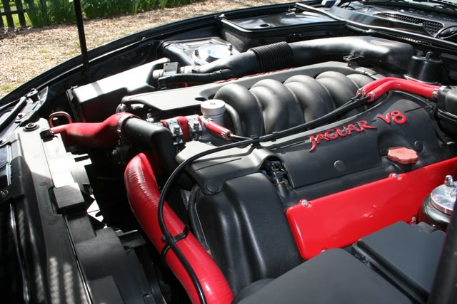

Thanks guys................ Here's a little peek at the engine and a few have wanted to see a pic of the start button

I am 100% certain you will find them in the US.... The trick is how you fit it, I had to machine up a tapered sleeve for it to fit nice, I also cut a groove into the shifter for the wire to sit in and then used some shrink wrap to cover it over, looks good....
