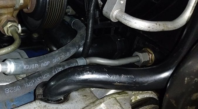

Hi Z,
That LHS clamp is well obstructed. It's the trans cooler lines blocking proper access - particularly to the front bolt.
I managed with a small ring spanner finagled from underneath: - disconnected both drop links which allows the front of the bar to be lifted for better clearance.
You might be able to loosen the lower cooler pipe and move it slightly sideways as its connection to the radiator is cranked? I think the plumbing is pretty similar at this end on both trans variants:
NB No AC compressor here so the view looks rather better than it is.
