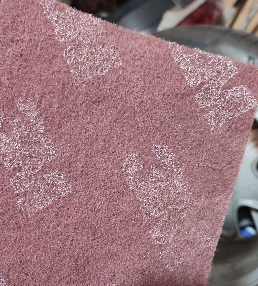

Sorry, I meant the abrasive sponge or scouring pad, like the kind used to clean machine tool tables (it's very mildly abrasive, less so than a wire brush). It looks like a kitchen scouring pad, but it isn't; it doesn't scratch. I'll send you a picture of what I use. If it's sandpaper, it should be fine (400 grit). I completely agree about grease on electrical contacts; it's best not to use it (you have to clean them when disassembling). In any case, for the battery, use battery contact protector spray, which dries after application. For other electrical contacts, no grease; for cleaning, use contact cleaner spray or isopropyl alcohol.
Yes, that's what I had in mind.
FYI, never use even those to clean areas where anything can get into the engine or other mechanicals such as when cleaning a gasketing surface. They have particles in them which are some of the hardest things on earth only varying the abrasiveness by particle size and quantity. They shed in use. Nasty stuff in the wrong places.
