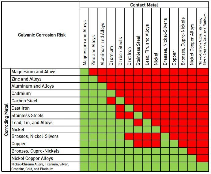

I regularly use copper, nickel and aluminum anti-seize compounds. To decide which is optimal for any given application, I consult a chart like the one below. On this chart, a red block at the intersection of a row and column indicates a higher risk of galvanic corrosion (GC), and a green block indicates a lower risk:
For most applications I use copper and nickel interchangeably, but when one or both components is an aluminum, magnesium or zinc alloy, I use aluminum anti-seize. Aluminum is slightly more anodic than iron and steel, so it will tend to be more significantly affected by GC when an aluminum and iron/steel part are in contact. I figure by using aluminum anti-seize, the risk of GC is at least no worse than it would be if the parts were installed dry (as they often were from the factory).
I use nickel anti-seize when a stainless steel part is involved, because the risk of GC is lower than with copper. I also use nickel anti-seize when temperature is a factor. Permatex copper anti-seize is rated to 1,800°F, while Permatex nickel anti-seize is rated to 2,400°F.

Thanks for the chart!!!!!!!!!!!!
I saved in my tech files.

Thank you Don!
This is a very useful chart for many applications.

Thanks for that chart of greases and their uses.
