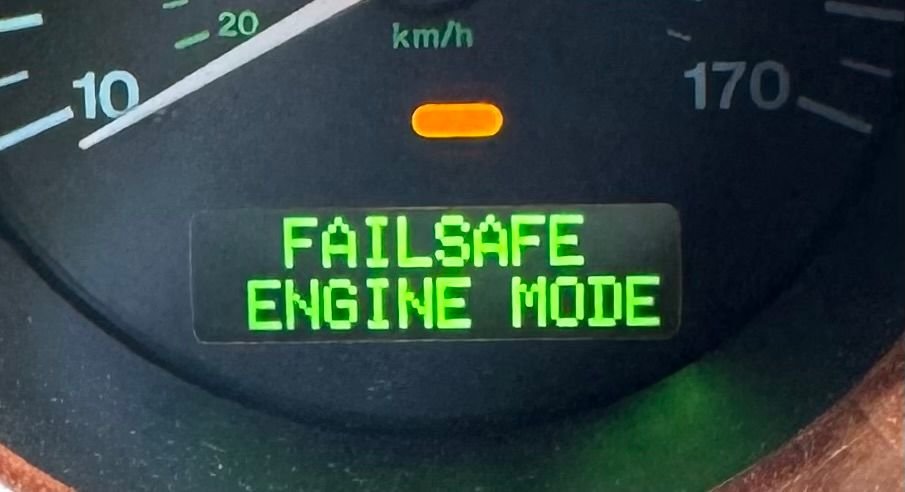

With the cruise switch left on when driving you often later get a warning about brake light bulb / ABS issue which is the pointer to your pedal switch being at fault ebay has Aston OEM ones or now China has copied them for a much lesser price. Easy way is to take the switch off new plate and swap that onto the existing plate in the car (many posts on how to do the whole switch replacement job)
I can encourage my cruise to work on occasions or speed up the error on the main panel by fiddling with the cruise buttons. Eg. When driving, press bottom two steering wheel cruise padel buttons just touch (is enough) brake pedal for 1/2 sec now try and set the cruise - it might work. Or same but the. Press the resume button etc. 50/50 I get cruise to work or it encourages fault to appear. (Fault goes away after a lock of doors or stop of engine for 30ish seconds) To pass a mot I just ensure cruise button is off.
So I know I have an intermittent fault (for 5 years) just never got round to buying new switch.

[img alt="Sorry. It is the dash errors. Says Check Rear Lights / Engine Failsafe Mode as per pictures if they appear here.
My example was inaccurate. I meant try when driving and cruise on pressing the Set and RES (hold) and tape the brake pedal. That sometimes resets things and I can hit Set and cruise works. This also brings up the dash errors more quickly. But the errors used to only come up once in a blue moon then they for more frequent. With Cruise off they never come up. Good luck with switch. "]https://cimg9.ibsrv.net/gimg/www.jaguarforums.com-vbulletin/1101x529/img_1130_c17679e3c7999dec8e2c652385f856d5e424441f. jpeg[/img]
Sorry. It is the dash errors. Says Check Rear Lights / Engine Failsafe Mode as per pictures if they appear here. My example was inaccurate. I meant try when driving and cruise on pressing the Set and RES (hold) and tape the brake pedal. That sometimes resets things and I can hit Set and cruise works. This also brings up the dash errors more quickly. But the errors used to only come up once in a blue moon then they for more frequent. With Cruise off they never come up. Good luck with switch.
