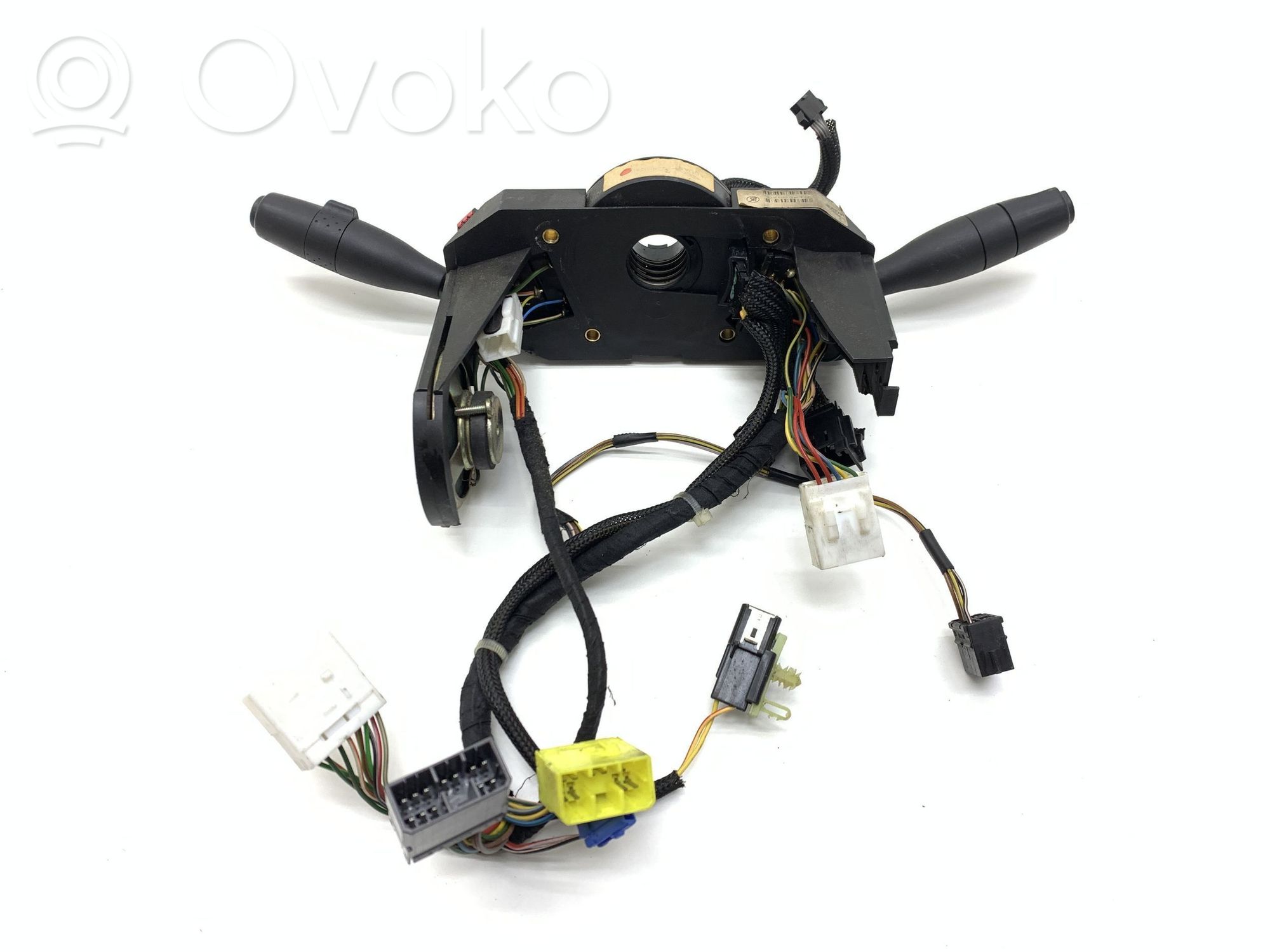

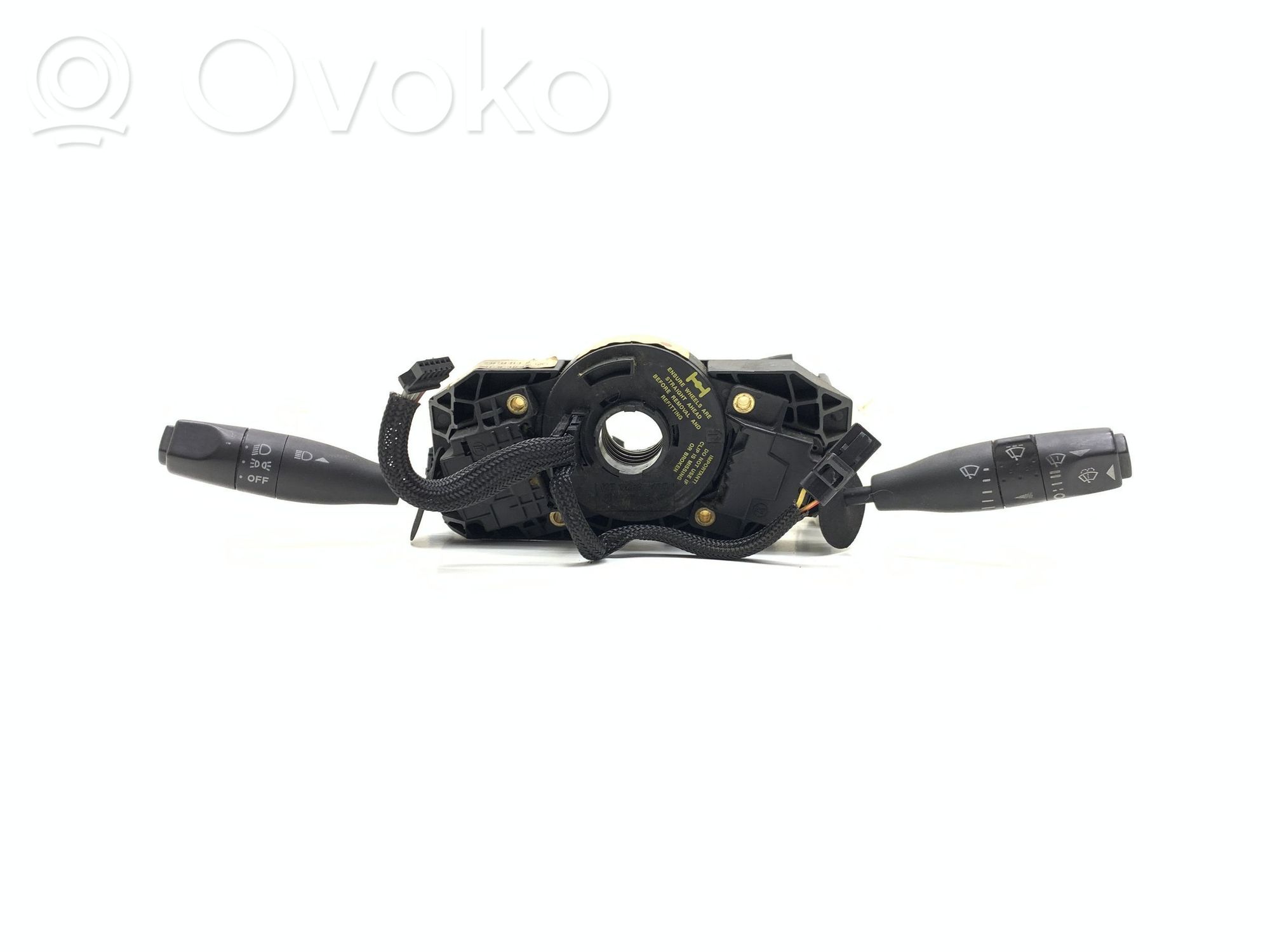

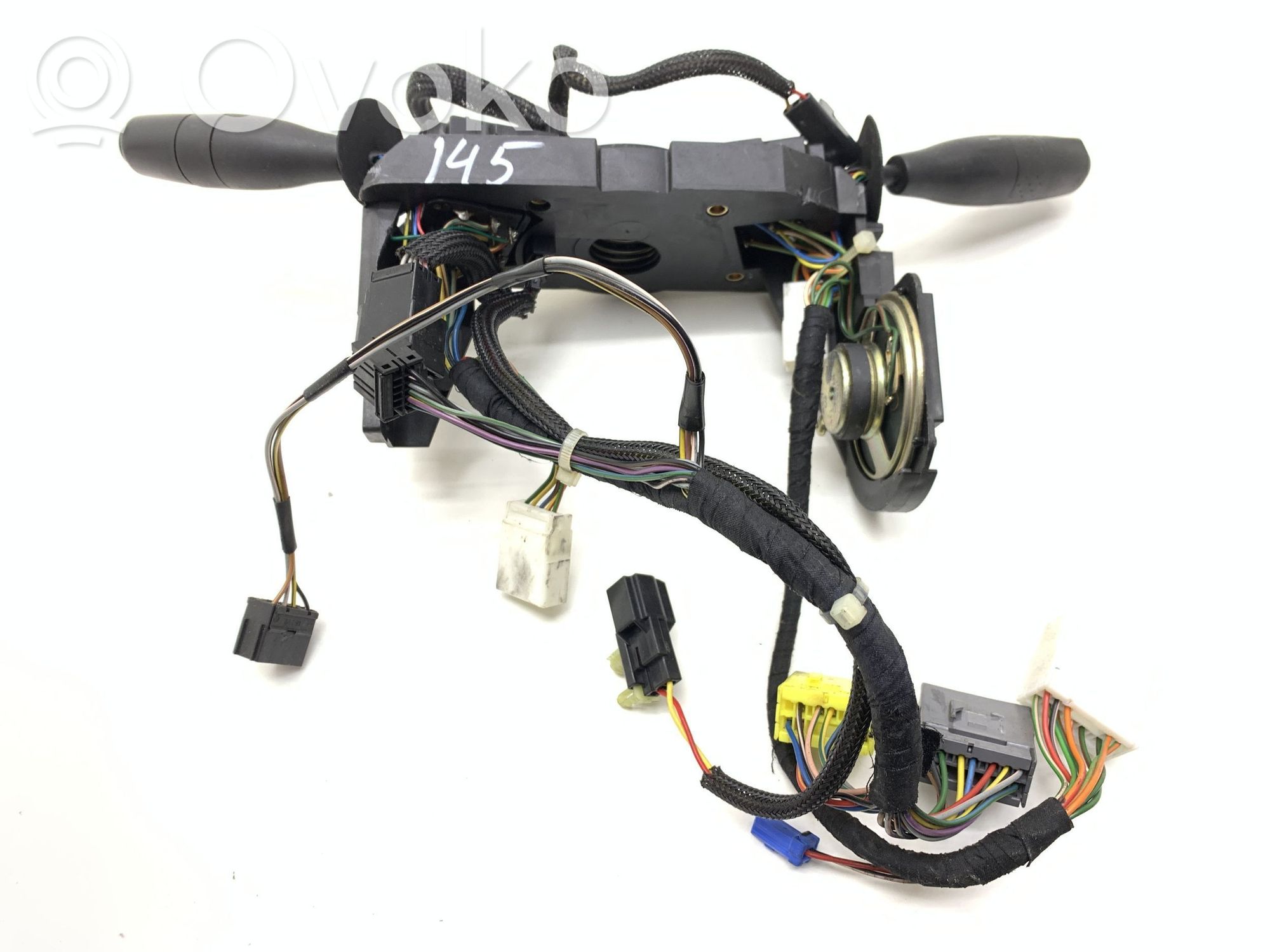

As for the buttons on the stalk assembly, all connections has to go through the so called "clockspring", a very thin flat cable winded up inside a cassete. I had mine open to have a looksie and from what i could learn the ods for that thing to fail is quite low. There is however a few youtubeclips on dudes repairing them.. but i wouldnt.. dont want to be slapped on the face by the airbag for no reason.
Anyway, that clockspringcasette is installed on the stalk assy. (see pictures) its a matter to find the correct plug to check what the contacts on the steeringwheel does.
Before any job involving removing the airbag, disconnect the battery first and wait 10-15 minutes before messing with it..
By the way, are your car equipped with the so called adaptive cruise control? Then there are a few more things involved in the troubleshooting..

  #55
OCJoeR's Avatar
Joined: Oct 2024
Posts: 455
Likes: 82
From: Orange County Califorina
Hi Einhead,
Those photos are of the headlight and wiper control buttons. I'm talking about the cruise control and radio buttons.
Joe
