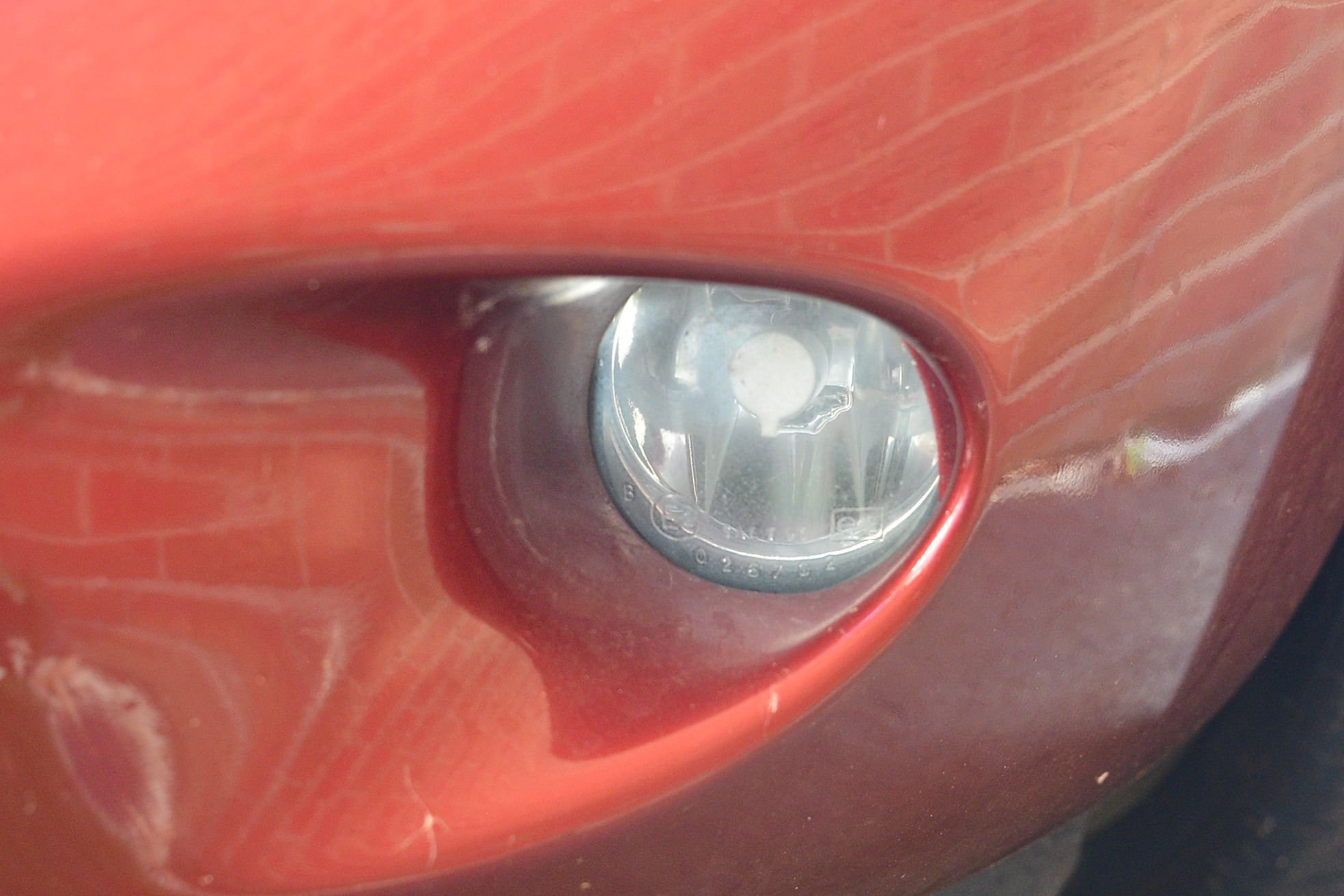

Just converted my spot lamps into DRLs No mods to wiring ..all in the fuse box ,takes about 5 min. Works with LED or HID dip units .

Some times here in UK called Fog lights .....The two on the outside low down on the front . When You go to ignition positon 2 they both come on ..when you turn on sidelights they stay on but putting on the dip or main beam they go off ,Have changed the 55w bulbs for leds at about 15watts. Just found some other old posts ..seems in US you keep the dipped lights on programing the vehicle via the OBD socket .
for this its just a couple of passive components added to the under bonnet fuse box.

My design will work with HDI and Led dip beam which my car has . Goes in fuse box 5 min to fit . no soldering or cutting. one earth connection to the bolt below the fuse box
