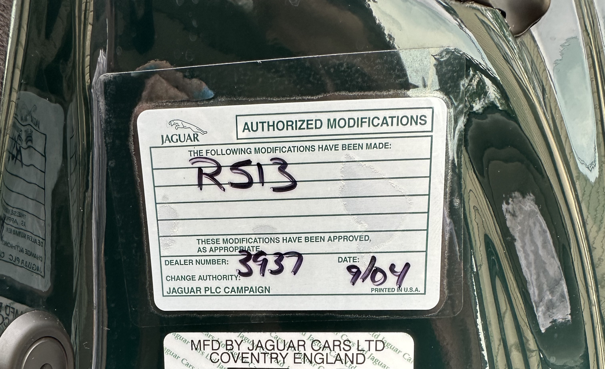

"Authorized Modifications" dealer sticker lists "RS13"?
Old Feb 9, 2026 | 07:27 PM
chilly's Avatar
Joined: Oct 2024
Posts: 85
Likes: 48
From: CT/USA
Default "Authorized Modifications" dealer sticker lists "RS13"?
Have this sticker on the door jamb on my 03' XKR conv in the US. Looks like dealer did something and marked it in 04' back when it was nearly new - says "RS13" I think. Any guesses what it might mean? Only non-stock things on it that I'm aware of are the Milan BBS 18" that I don't even think are for the XKR... and a front grill I had assumed was aftermarket.

I recall the “R513” was a recall relating to the transmission shift protocol. Something about inadvertently shifting into reverse or similar. There is a TSB on exactly what it entailed. This was performed by the dealer network when the car was taken in for service or customer complaint. This was also completed on my 03 XK8 although my sticker was put on the radiator support!

Great eye! I can see the recall listed now with the 5 not the S. Thanks.
