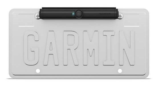

I just installed a Garmin BC 40 back-up camera that pairs with our dash-mounted Garmin GPS. A very simple plug-n-play solution for our XK8s. The camera is powered by two AA lithium batteries and mounts above (or below) the rear license plate. It pairs wirelessly with the Garmin screen on the dash. Reverse view activates automatically at start up, and then reverts to map screen after car is moving forward. Also supports voice commands.

I work at Garmin (so I am likely biased), but I also have the BC40 set up and i removed my OEM GPS screen for a Garmin Drive. I've gotten used to having a backup camera and as the OP said, it works on batteries with no additional wiring. I can pop the original screen back in later if I want to.

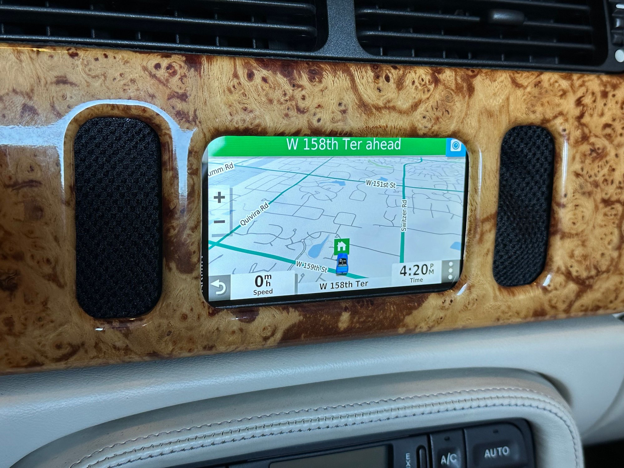

Having just purchased a 2002 xkr Im wanting to convert the original GPS screen and add a back up camera. Could you enlighten me as to which Garmin unit you used so I can purchase it and the backup camera and go the same route as you? Thanks!

Mine is the Garmin Drivesmart 55 which is a good match for the original screen size, being only slightly smaller. There are lots of threads on the forum on how to do the install, you can be very basic and just glue it on to the back of the veneer panel, or you can dismantle the original sat nav and replace the screen with the Garmin, keeping the buttons etc - that requires quite a bit more work though, but keeps the OEM look.

If you wish to replace the original factory GPS unit, a Garmin with the 5” screen is best. Most newer models are compatible with Garmin’s backup camera, but do check the specs. Since our XK8 has the 3-gauge cluster instead, I prefer the 7” version fixed to the dash above the glove box. Be aware Garmin’s BC 40 camera is not HD resolution, and does display a wide-angle view.

5" is too small and leaves noticeable borders either side of the display. The Garmin Drivesmart 55 has a 5.5" screen and is a much closer match to the original screen which was slightly bigger (IIRC 5.7"). The 5.5" looks practically OEM unless you look closely.
