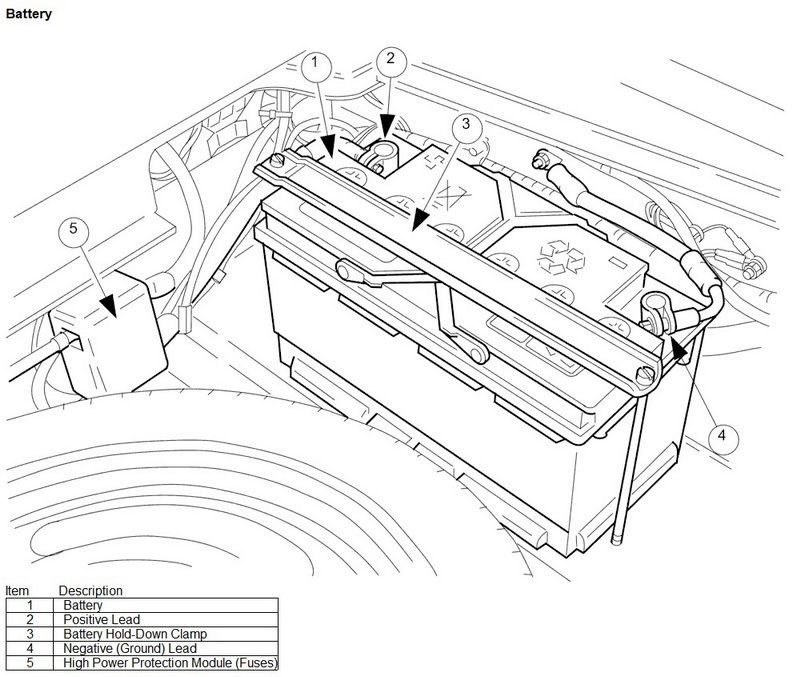

The obvious place to start is testing the battery as this is the number one cause of weird electrical phenomena in the V8 Jaguar models. However, the total failure after a lengthy drive is unusual. A partially discharged or failing battery will usually be sufficient to power auxilliary functions but not to start the vehicle.
Check the HPPM (High Power Protection Module - see item 5):
The cables are known to work loose or partially break and this can cause the behaviour you describe.

+1 to above comments esp. GGG’s comment. Zero dollar check/fix on HPPM.
The positive battery cable connects to big fuses at the HPPM. Connection should be grit papered cleaned and shiney and sprayed with contact cleaner not WD40 and bolted tight.
