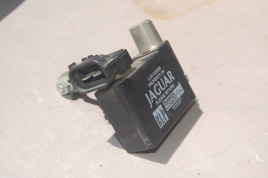

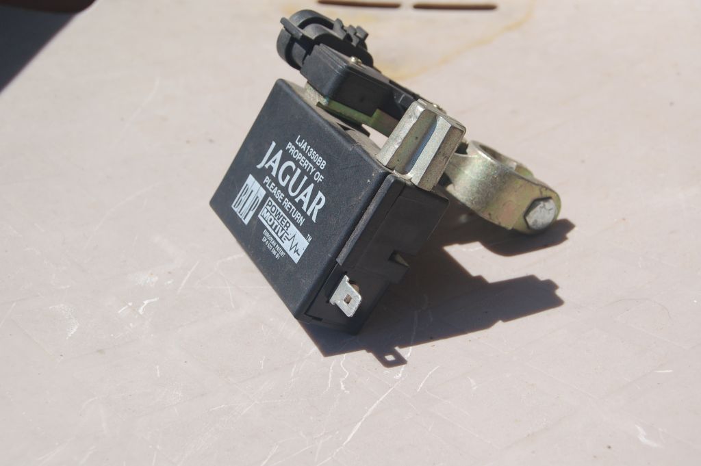

The Jaguar 'transit-relay' or battery isolation devise disables the entire car EXCEPT the door modules.
The windows still need to 'drop' slightly when the doors are opened.
When I disconnect the XK batteries, I open both doors, open the boot lid and then disconnect.
Close the boot lid and doors, then you will not damage the door or glass.(the glass will not raise back up)
You can also locate and install an old Jaguar XK transit relay if you only drive the car very infrequently.(like a Jaguar sitting at the shipping port or dealer)
The windows and things like radio head unit will need resetting each time you 'wake the car'.
I use the generic battery disconnect devises on some of my cars.
The daily drivers don't need one but the 'once-in-a-while' cars do.
I got used to seeing them in the boot panel of Rolls Royce Silver Shadows years ago. They do keep batteries from slowly dying.
This an actual pic of an X100 transit relay or battery isolation devise.(one I forgot to return to the parts dept. OOOOPS)
