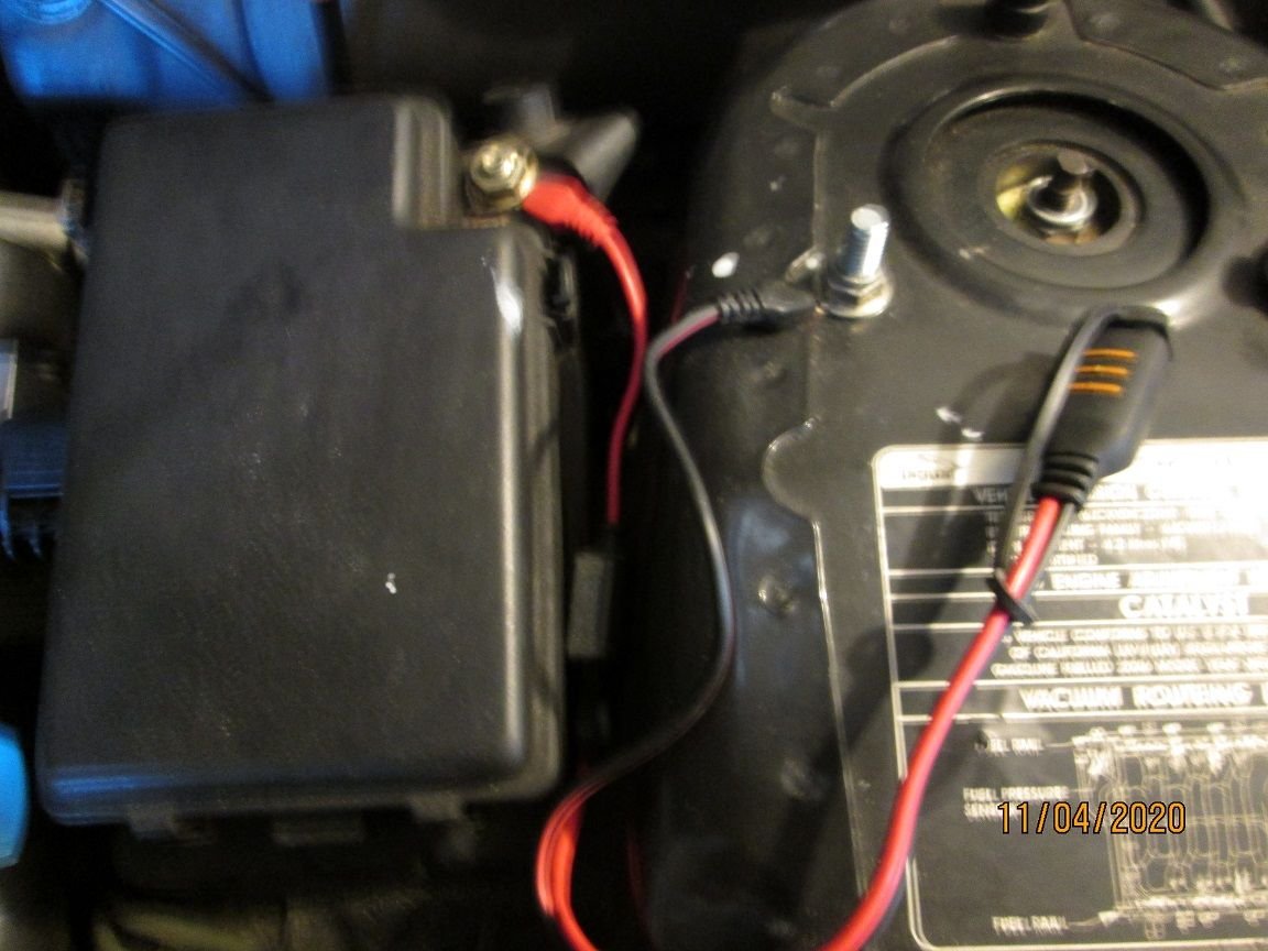

There is no need to connect to the battery. Use the fuse box on the left side of the engine compartment like I do for my CTEK maintainer in the attached pic.
