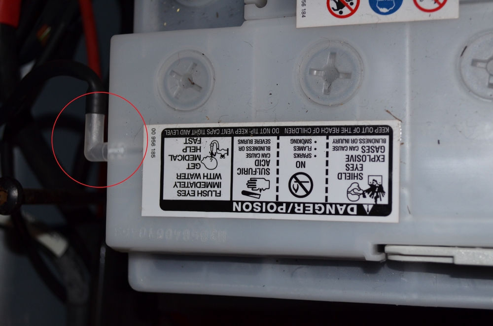

Thanks! I found where the hose would connect to the battery, but now I can't tell how to connect it as I don't see any nipple on the battery and all I have is this hose:
Is there anything non-oem that I can get to replace the nipple?
And there is also a barbed coupling and a slightly fatter hose with an elbow:
Are those oem as well?
And lastly, there is some kind of rubberish pad in the center of the battery tray:
Is there something else I can put there instead??
Sorry for all the questions, but with the vented battery in the trunk I just want to make sure that everything is done properly so I don't have any acid related issues later on

On mine that tube and elbow connect to the vent on the end of the battery at the top (nearest the front of the car) and exit via one of two rubber grommets just in front and to the right of the battery tray.
Picture below shows my battery tray (before painting) and the location of the grommet.
And here is a pic of the vent tube on the battery:-

blind your picturein the right corner shows a rubber tube going to the front and down thru the floor... think that's the battery vent and someone stuffed in into the trunk liner front panel ... the battery vent s/b under the top lip of the battery somewhere around the positive terminal if I remember right and any of the top of the line batteries will work well just get the best deal and the longest warranty as xk's eat batteries like kids eat fruit loops . also check the flap where the key goes into the ignition switch .... its notorious for sticking open when key is removed and making the computer think the car is on . another thought you may want to put a layer of baking soda in the bottom of the battery tray to neutralize any possible spillage if it happens .
