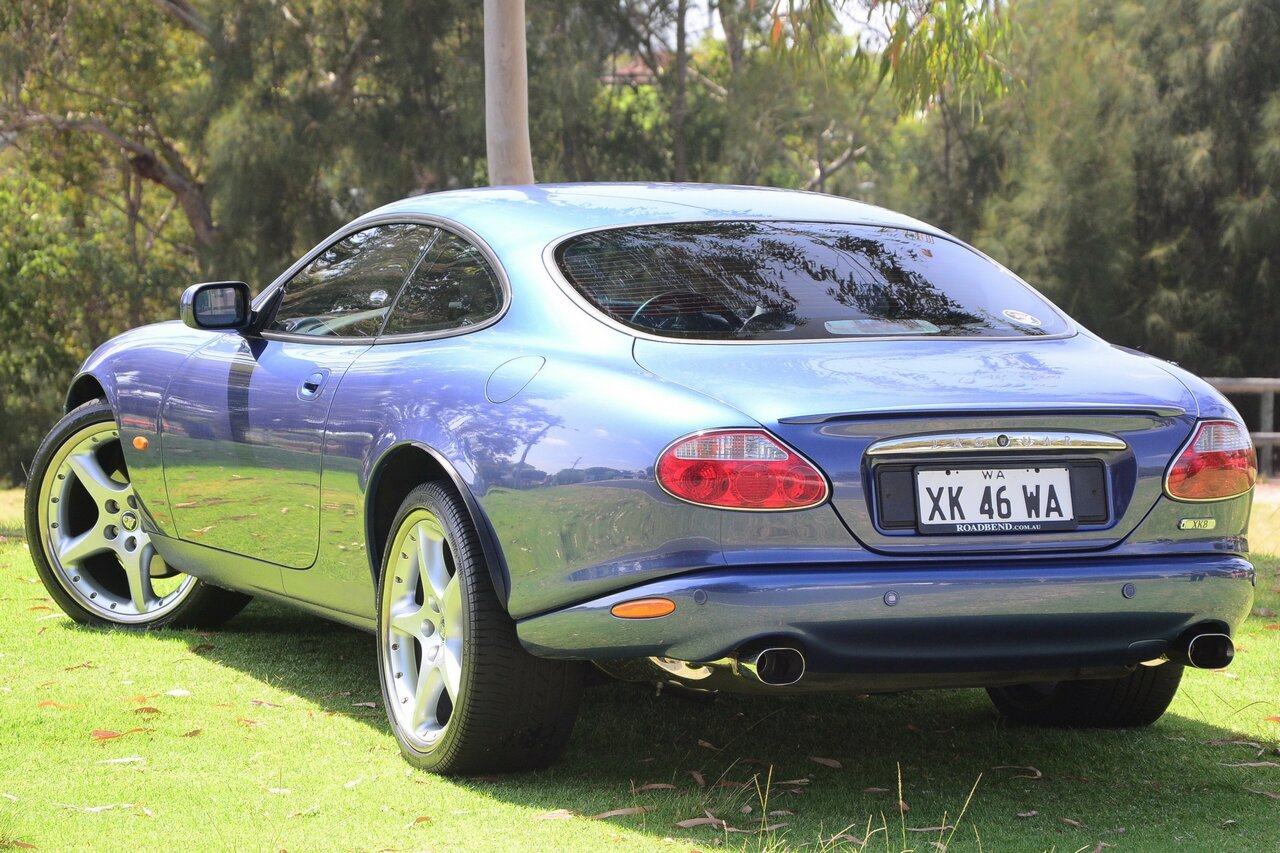

20" BBS on mine with Pirelli Pzero rubber. Some hate the screw-in valve extensions but, along with recessed locking nuts, hopefully deters some . . . and amuses others. I love 'em. I love 'em.
Ken

Cat as Trophy -
That is one BEAUTIFUL ride

Thanks Chris . . . We love it. I say "we" as my adult daughter has already "inherited" it and phones regularly to ensure I have warmed up or washed "her" XK8. Then I see your gleaming convertible, another fine car, and start wishing for more space in Ken's Kattery . . . home also to a sole XJ-S in a litter of sedans; Jaguars of course.
Hey Brad . . . it strikes me that much of what you are contemplating, moving to 18"x 8" and beyond, is exactly what Jaguar themselves did as the XK8/R and its contemporaries like the S-Type, developed . . . first 17", then 18" became the default standard, with 19" and 20" as factory options . . . and just like the STR, wider at rear than front.
Another issue is ready availability of Jaguar spec tyres . . . not cr@ppy H rated el cheapo's, but full spec . . . and at less than "sell the kids" prices. So mine has Pirelli Pzero 255/35ZR20 on 20" x 9" BBS up front and Pirelli Pzero 285/30ZR20 on 20" x 10" BBS at rear. I would argue that the ride is no harsher than our S-Type on similarly tyred 245/40ZR18 on 18" x 8" Mercurys all around. Speed & Load Ratings are 99Y. IMHO, they don't come any better. One caveat . . . with drive wheel rubber that wide, caution is warranted to prevent gravel rash ruining those tuck-away rear body panels.
