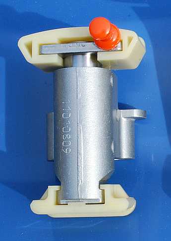

Don't remember about 'bigger' but they are left and right. I just looked at the old plastic ones replaced and one is about 3/16" taller than the other.

Originally Posted by giandanielxk8
The tensioners have arrived. I have noticed that one of them is bigger than the other one. Is this a mistake or is that how it's supposed to be?
Right and Left Tensioners are not the same, but they're about the same size and should look like this:

They should be different, one of them is mounted inverted.

Well, according to Paul's picture, they're the correct ones. One of them is inverted. Well, now I need to make time to install them.
