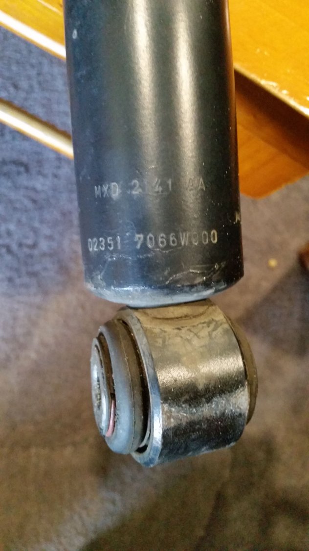

l believe all 'R' performance parts carry the MXD prefix. I discovered some years ago that the originals on my own car however carry a part number one digit out.
