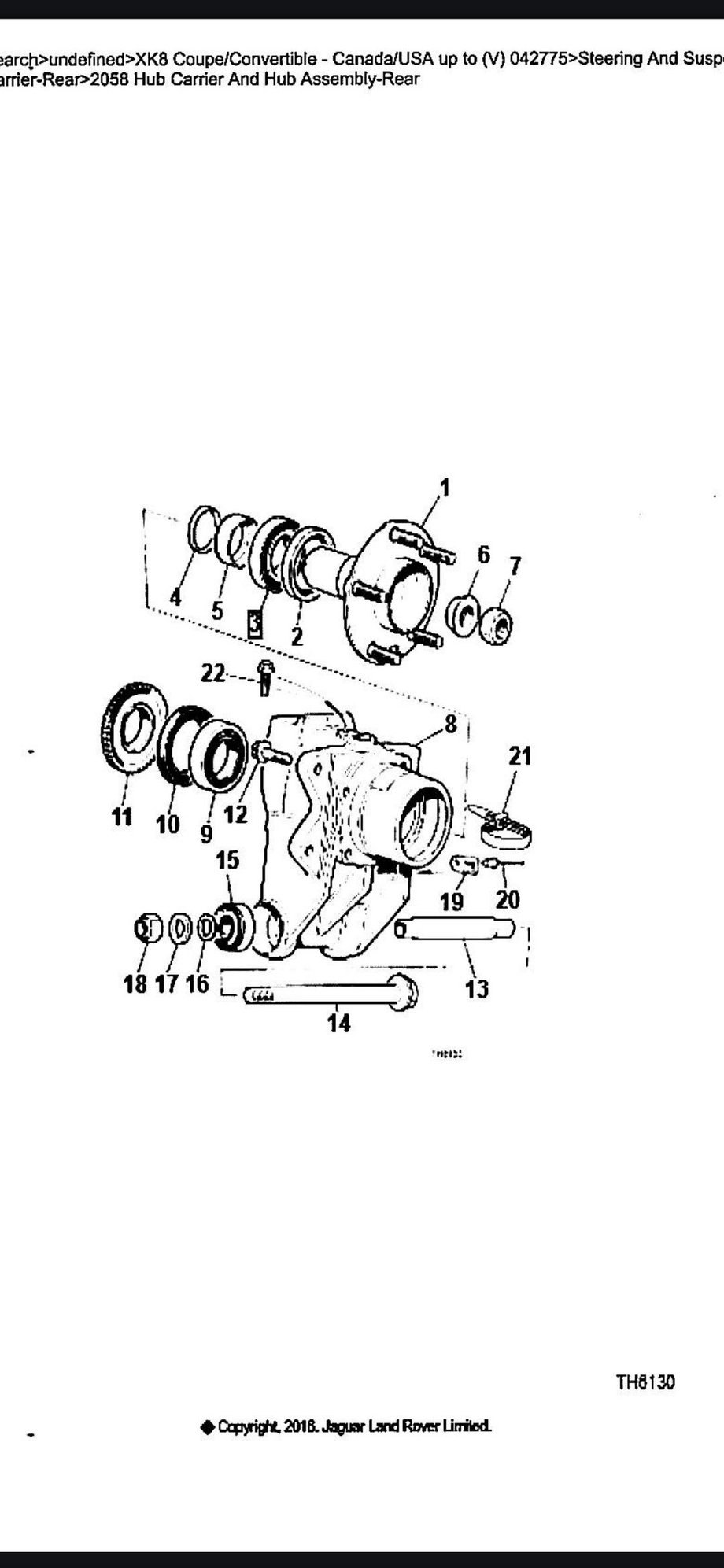

Might be pivot pin taper bearings in rear hub assembly.

Agreed. I just had my rear taper bearings replaced. My symptom wasn’t a rattling sound, but more of a loose wiggle from the back end every time I hit a bump at higher speeds.
FYI, the pivot pin was impossible to find, so luckily we were able to reuse it and just replace the taper bushings and sleeve with new, and the problem was solved. There are two pivot bushings on each hub assembly. The diagrams only show one. Referencing numbers 13, 14, 15 in the diagram.
