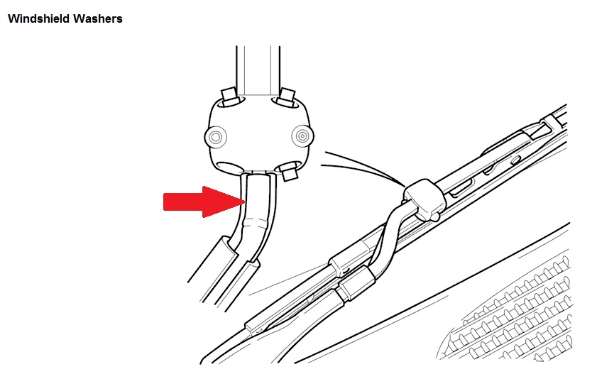

Possible damage is:
1. blocked or split feed pipe
2. blocked or split 'duckbill' nozzle
3. nozzle block been knocked out of position on the wiper arm
The jets can be cleared with an aerosol can of compressed air supplied for cleaning PC keyboards.
Disconnect the feed pipe (arrowed in red) and insert the tube of the aerosol into the nozzle block to blow the three silicone rubber 'duckbill' nozzles clear.
If the flow is OK but the direction is wrong, the nozzles can be adjusted using a small screwdriver to carefully lever them around. Go easy - a new nozzle block is around £65 from Jaguar!
