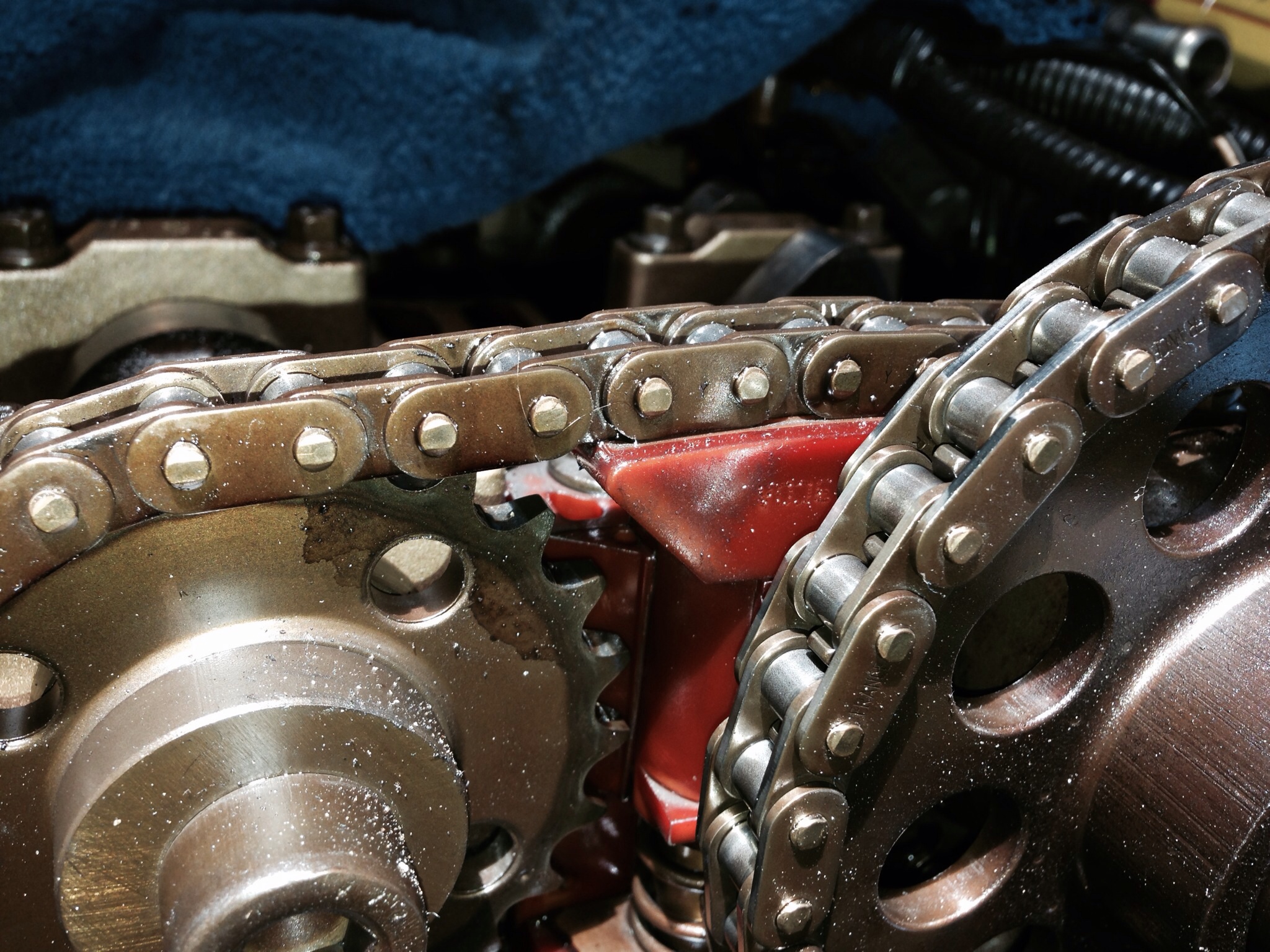

He chain on the right side of the motor kinda flaps around. You can tell the guides are toast. This is also the side of the engine I suspect problems. So...domI replace all do the guides? The chain?

Can you post closeup pictures of the upper (secondary) and lower (primary) temsioners? All I can see from the photo so far is that you have the old plastic style secondary tensioners.

Default Better pics?
The chain is so loose, there is a gap between the guide rail and chain. This is the right side, where I suspect damage to the head.

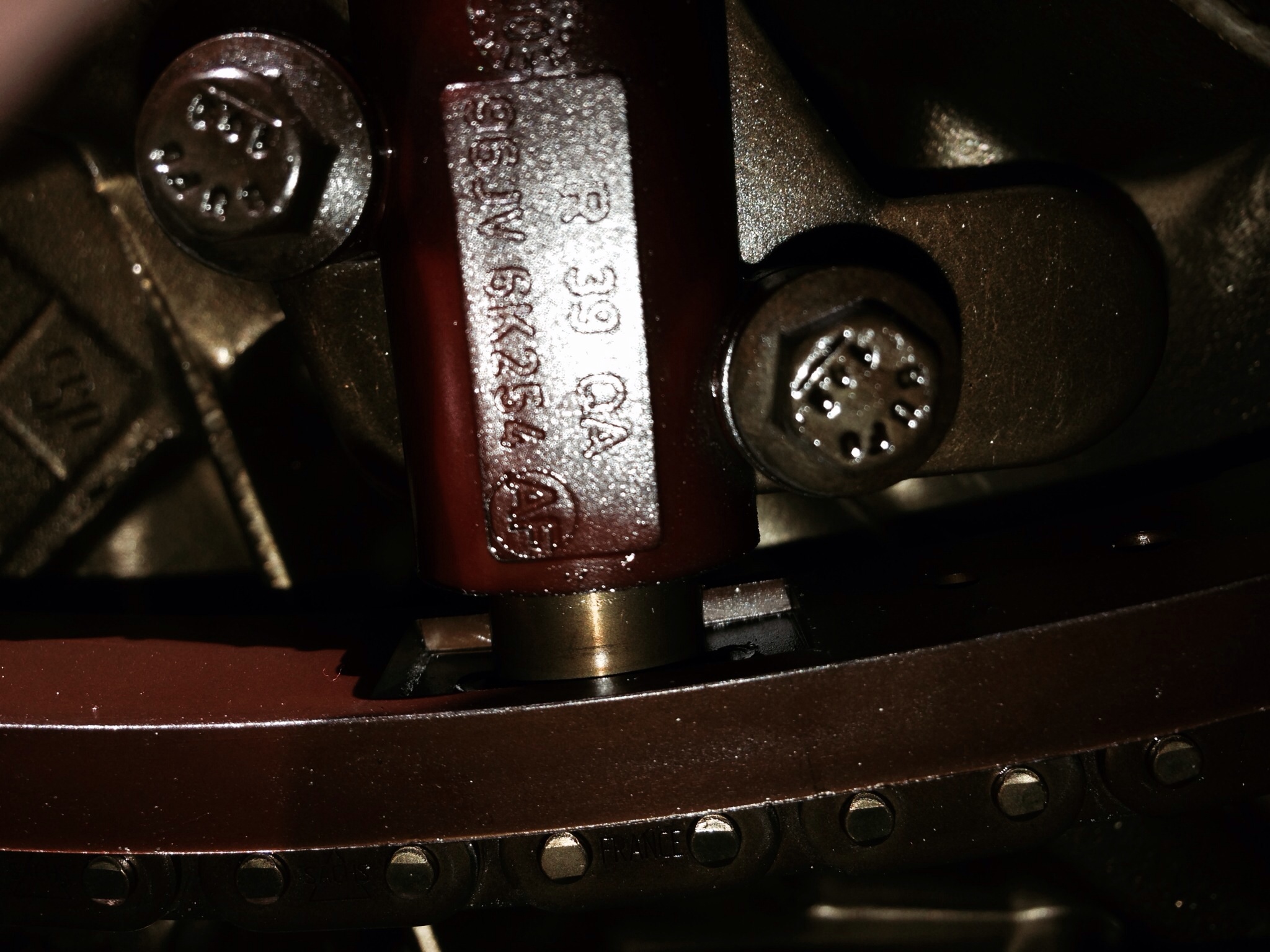

Default More Pics
It's the old style, right side, nothing looks bad.

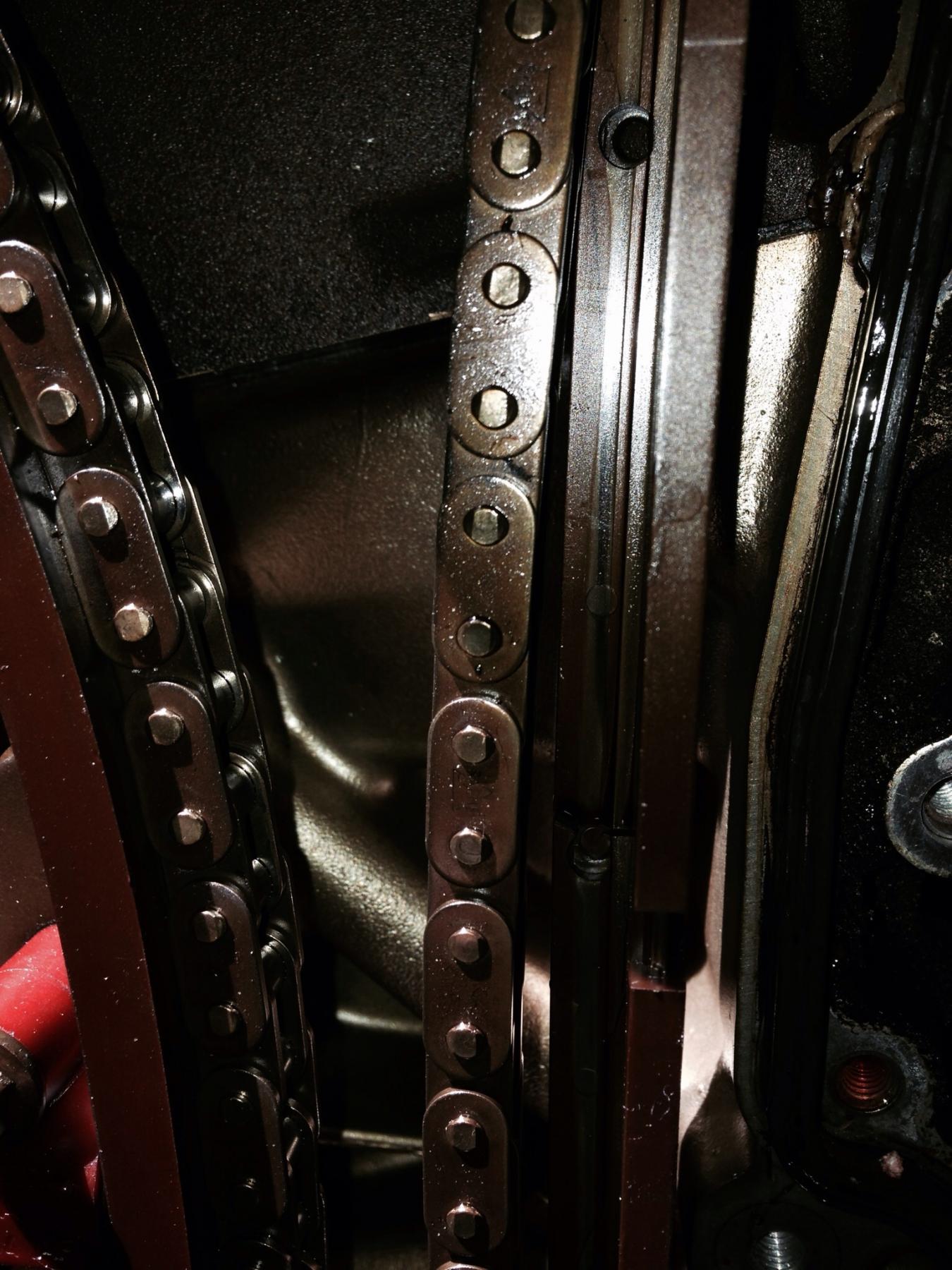

Default Another...
Left side looks fine.

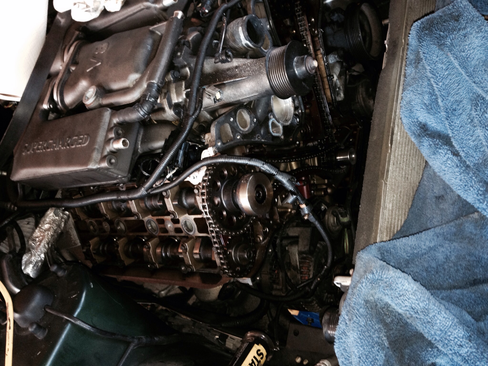

Default Pic

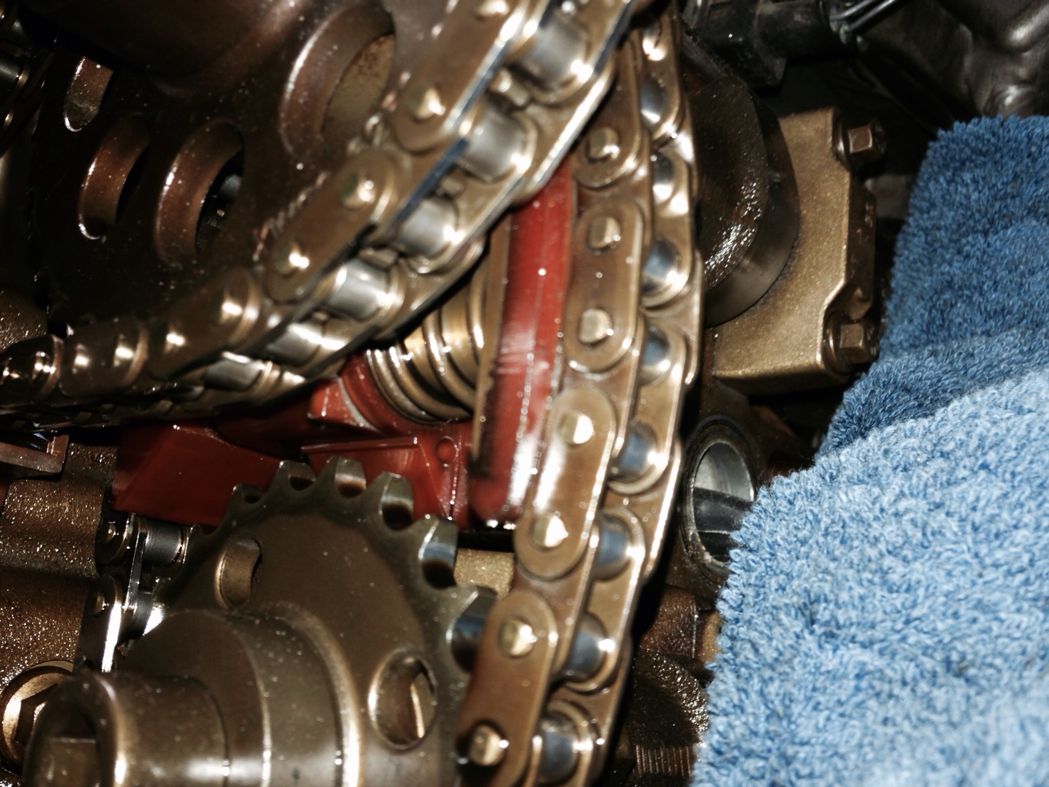

Default Pics
Are these any better? Hard to take them in that space.

From: Daytona, USA
You should check static timing at this point. I believe the procedure would be in JTIS, and to do properly would involve the crankshaft locking tool underneath the car, and the cam hold down tools on top. If everything lines up, then it would be safe to do a compression test. If that passes, install new guides and tensioners, follow Gus' instructions for a cyl wash start-up and cross your fingers!
