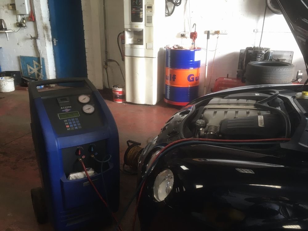

This is the equipment they use on mine:
It removes the entire charge content by vacuum, then pressurises the system for 7 minutes to check for leaks. If the pressure doesn't fall during that time the correct weights of refrigerant and PAG oil are added.
