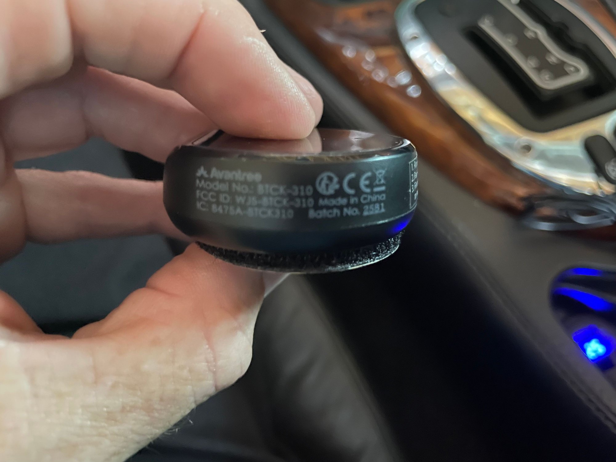

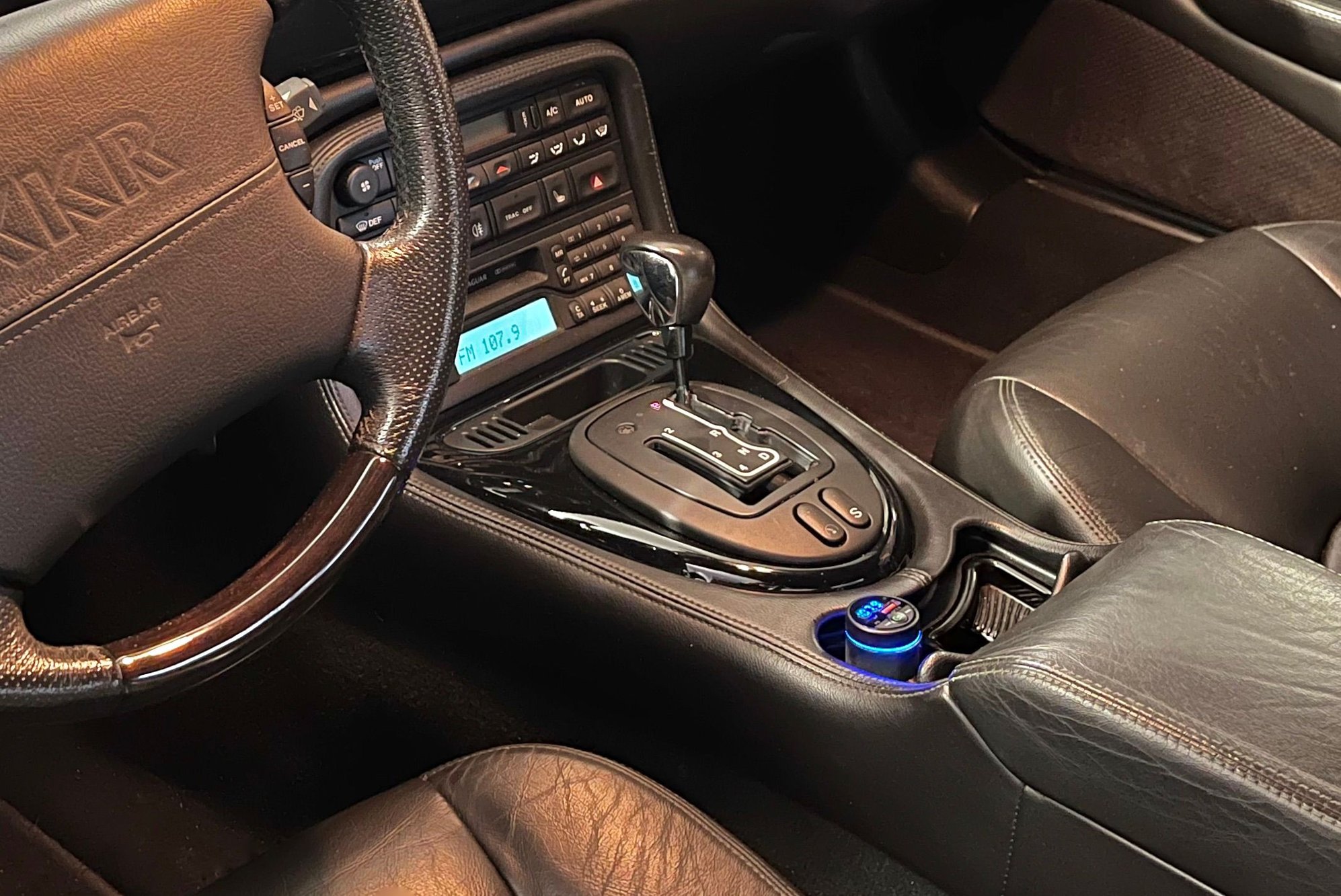

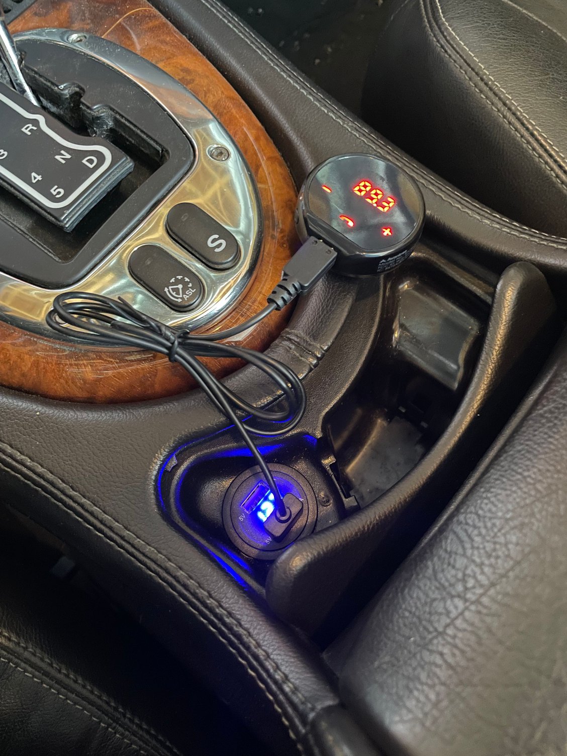

I thought I would share with everyone the success I have had with the Avantree CK310 purchased from Amazon. It is a very small Bluetooth transmitter for the audio system. It can be used with its internal battery or permanently connected to a usb power source. I have replaced my cigarette lighter with a usb outlet as documented elsewhere. The unit is small enough to sit under the cover adjacent to that and powers on when the car ignition is on. I was pleased that it works well with the antenna mast down. I have installed a switch to allow me to toggle that when the audio system is on. The sound is good to my ear!!
