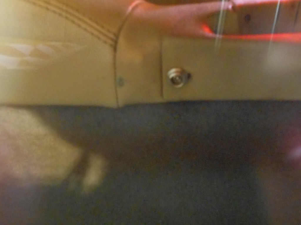

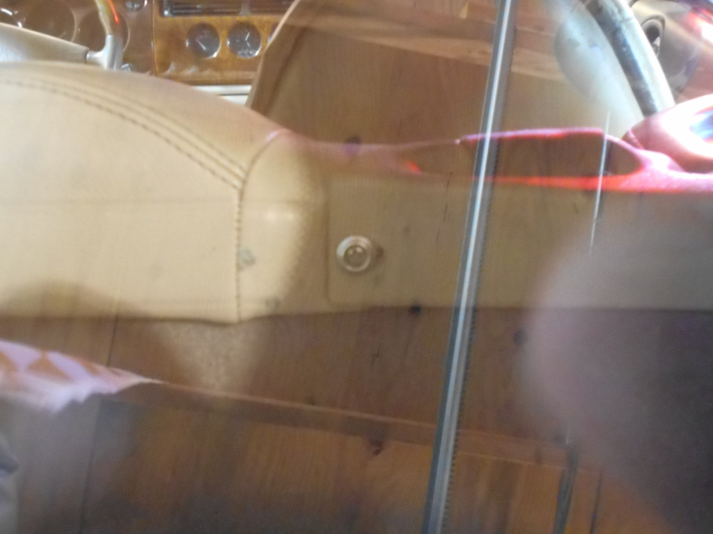

To help the situation out, I also drilled and installed a snap on each side between the headrest, and where the seatbelt goes down. That also keeps air from getting underneath the cover.....At the moment there is no engine in the car. I took the picture through the back glass...Good Luck......Mike
