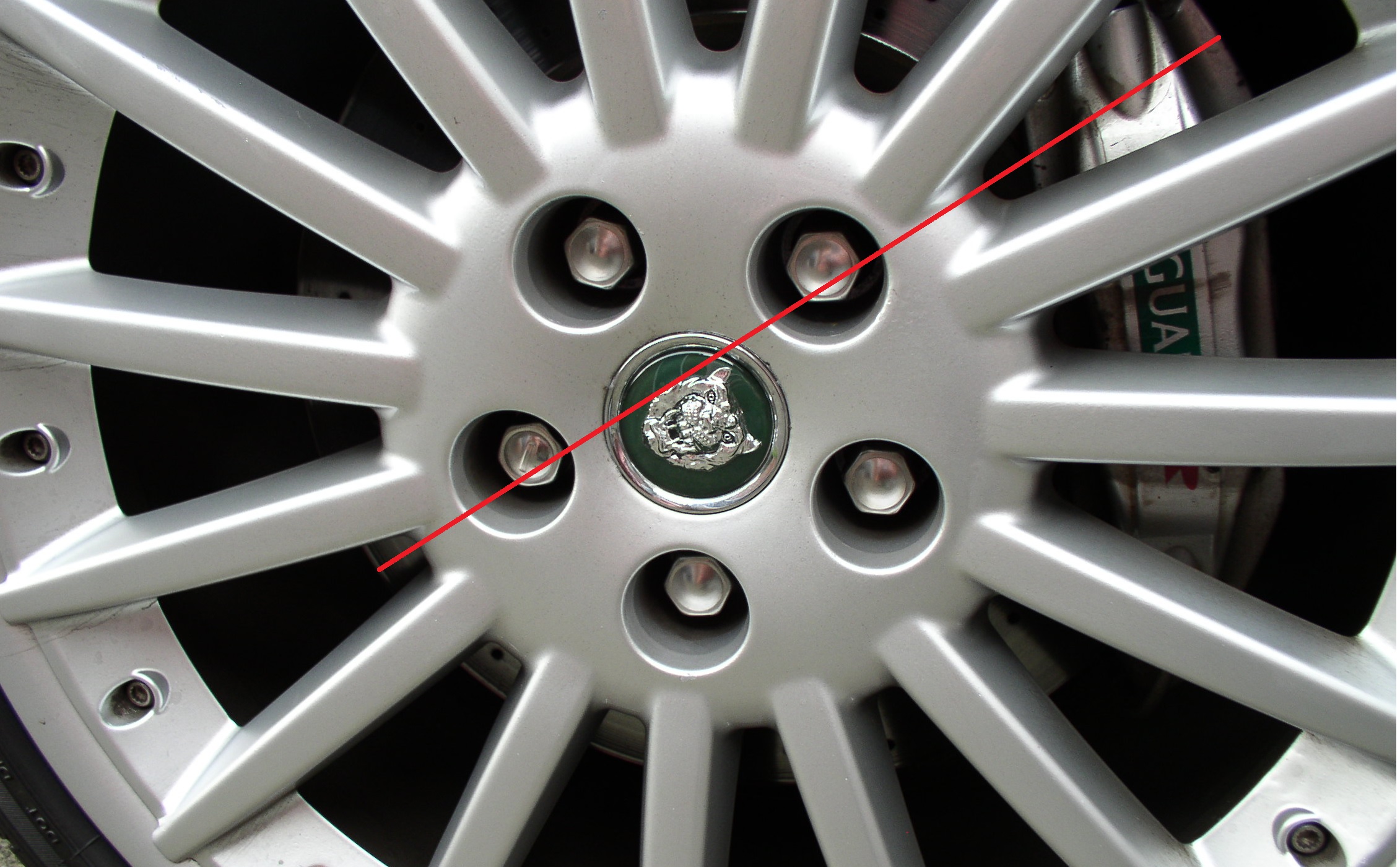

Originally Posted by Rovinghawk
Without taking the wheel off & measuring the disk, is there any way of telling its size (305 or 325mm)?
On both my 2001 XK8 with Impellar wheels and 2005 XK8 with Sepang wheels, I could see the discs through the wheels sufficiently to be able to measure the diameter ........
Brake disk/rotor size-diameter.jpg
Marked with a red line in the photo.
