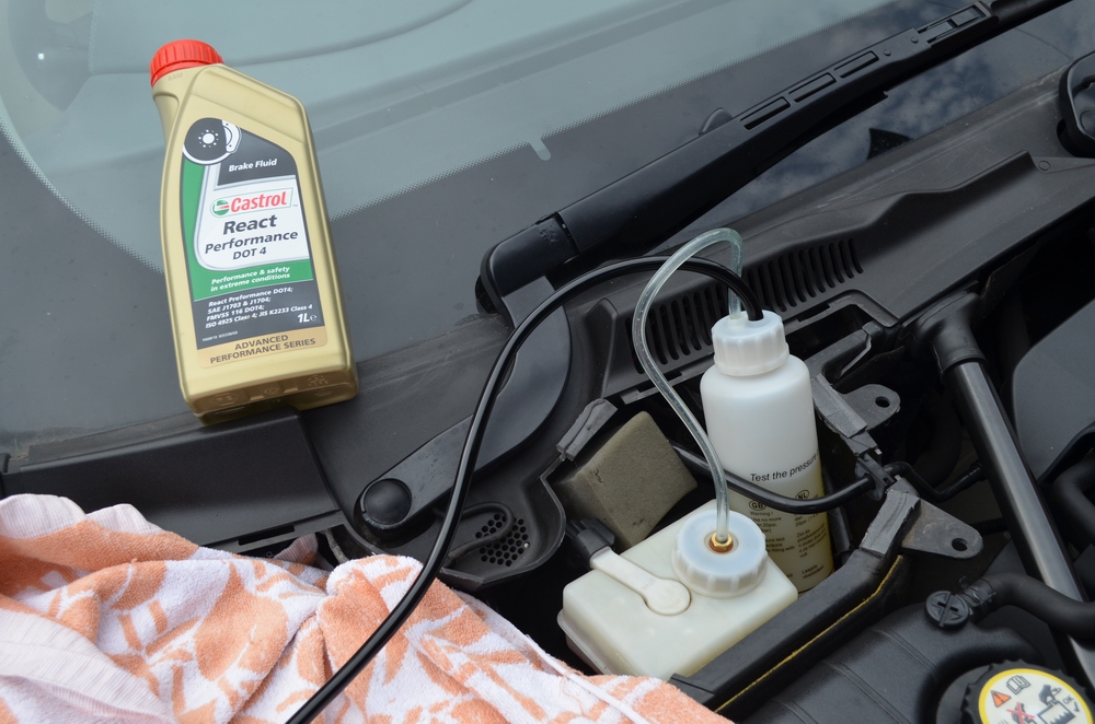

The pedal should feel firmer after a fluid flush but, assuming no other faults have developed in the braking system, it shouldn't take any more effort to hold the vehicle.
I'd suspect air has got in during the bleeding. My preferred method is to use an 'Eezileed' kit which ensures the fresh fluid is delivered under pressure:
This is my XK but it works just the same on any vehicle. Makes it a single handed job with no need for any pedal pressing.
