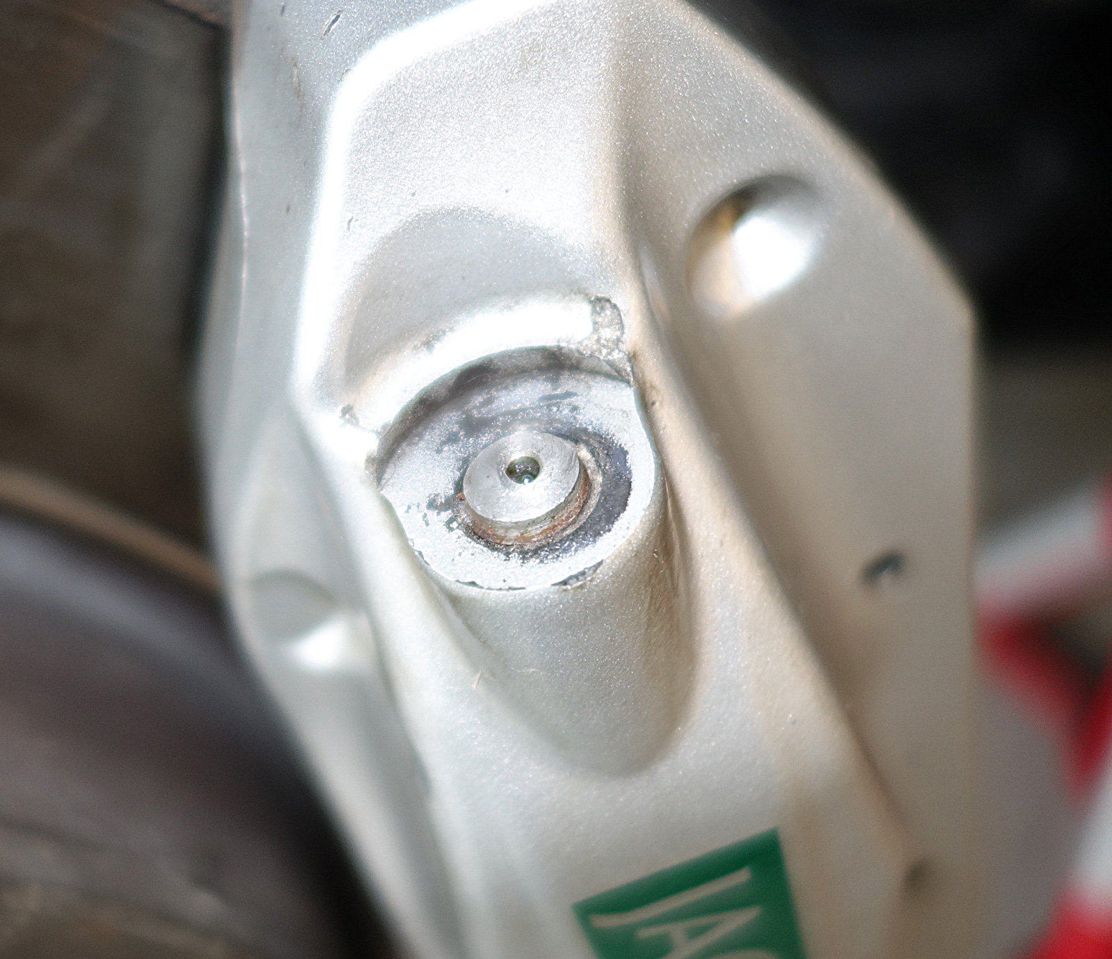

Snapped a picture of the mess...

1 minute job with an easy out - a reverse threaded screw...
Old Aug 3, 2014 | 05:58 PM
There appears sufficient protruding to be able to cut a slot in it and use a manual impact screwdriver.
The visible thread is rusted and a good pre-soak with penetrating oil has to help.
I'd normally apply heat to free a seized bolt or stud but that would damage the silver finish on the caliper.
