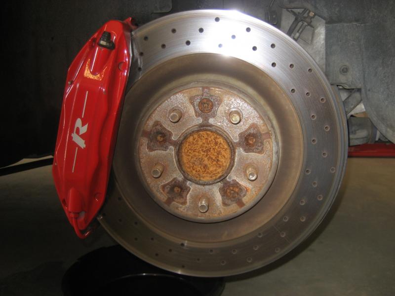

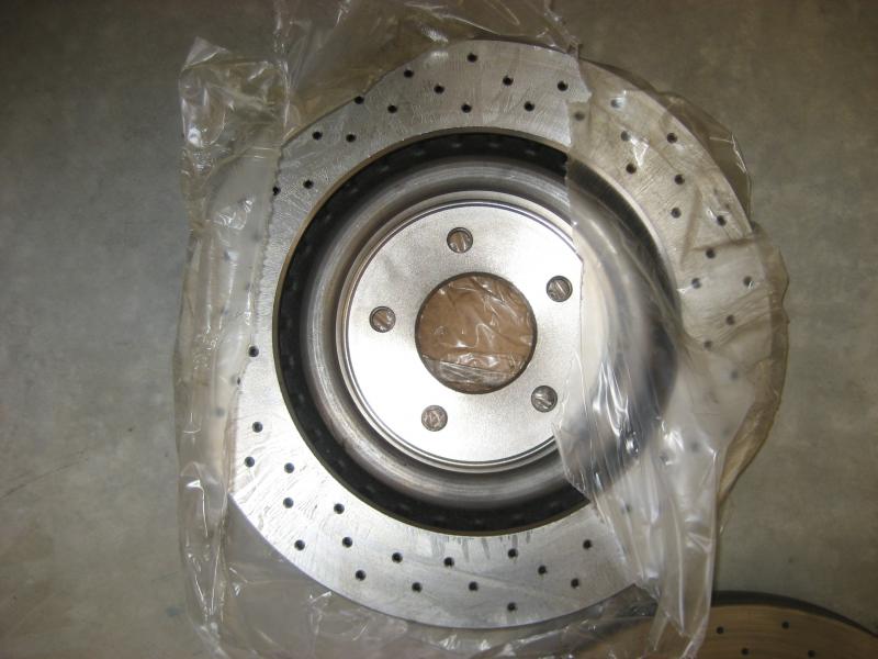

I ordered a pair of brake rotors - Part # JLM21749 and upon opening the package I noticed everything looked correct except the existing rotors have additional holes drilled between the lug bolt holes. I also see what appear to be Torx bolts in two of the holes. To add further complication there is no reference to these additional bolts or holes in my JTIS. I have attached images for reference.
Anyone have a clue of what is up with this? I have contacted the supplier via e-mail but it is Saturday and I am sure I won't hear back until Monday. I am in no rush as this is a " I may as well as" project related to replacing my power steering rack, but I trust this board more than anything else. I thought it would be straight forward but is anything anymore?

Treat this suggestion with caution as it's based on photos from various aftermarket brake specialist sites I've viewed today trying to find a Hawk Ceramic pad supplier in the UK:
The photo of your existing disc with the five additional holes looks like Part No C2N3428 fitted from VIN A41033. The replacement looks to be Part No JLM21749 for vehicles up to VIN A41032.

After further investigation it appears the correct part is C2N3427, but thanks for getting me on the correct path. C2N3428 = non cross drilled rotors but still Brembo compatible; I didn't know they made them without cross drilling but I think I just saw it noted in the other thread you started about the soft pedal feel. - FYI I have been using Hawk HPS and have been very pleased, a bit more dust than the ceramics, but nothing like the stock and they have great stopping power, once they are warmed up.
Re: the rotors - They listed the part as applicable and I provided the VIN too. We will see what the vendor says.

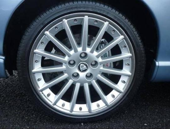

YES - about 60 feet away as I'm typing this.

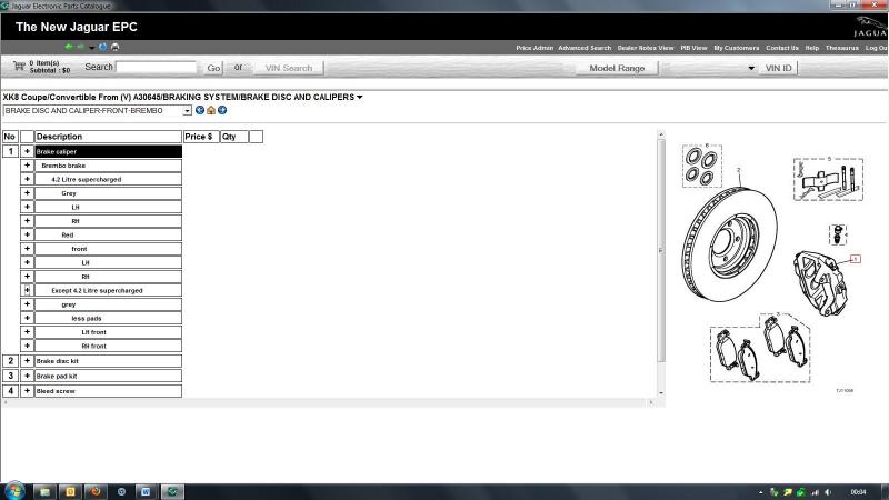

Markets vary so what's made available in the UK isn't necessarily so in the US and vice versa. Here some models came fitted with red and others with grey:
The EPC lists both colours. Anyone going for a replacement would want it to match the other three.
Attachment 16627
Over here it's listed as an option, which would be noted on the window sticker. If it's not on the sticker and you have them, they've been changed out or painted by a 3rd party.
As for being higher performance, sure, why not. They're red, they must be better.

Attachment 16627
"The EPC lists both colours. Anyone going for a replacement would want it to match the other three."
What does it mean to list Red and Grey for the 4.2 Supercharged and right below it say "Except for 4.2 Supercharged" and only list Grey?
Does anyone speak 'Jaguar' that can translate that contradiction?

....................What does it mean to list Red and Grey for the 4.2 Supercharged and right below it say "Except for 4.2 Supercharged" and only list Grey?
Does anyone speak 'Jaguar' that can translate that contradiction?...........
jj
jj,
The answer is in an earlier post. There's no difference whatsoever.
