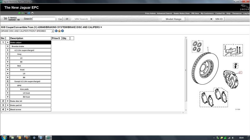

Markets vary so what's made available in the UK isn't necessarily so in the US and vice versa. Here some models came fitted with red and others with grey:
The EPC lists both colours. Anyone going for a replacement would want it to match the other three.
Attachment 16627
Over here it's listed as an option, which would be noted on the window sticker. If it's not on the sticker and you have them, they've been changed out or painted by a 3rd party.
As for being higher performance, sure, why not. They're red, they must be better.

G, G, G,
Everything is either Red or Grey for you isn't it.
Attachment 16627
"The EPC lists both colours. Anyone going for a replacement would want it to match the other three."
What does it mean to list Red and Grey for the 4.2 Supercharged and right below it say "Except for 4.2 Supercharged" and only list Grey?
Does anyone speak 'Jaguar' that can translate that contradiction?
Think how crazy we could drive some forum members, well actually all of them, by painting just one caliper on their cars a different color.
Or you could have red on one side and grey/green on the other to go with whatever the wife/husband is wearing that day. After all you can only ever see one side at a time.
Cabin fever is getting a little high here after being snowed in for over a week.
jj

Originally Posted by jamjax
....................What does it mean to list Red and Grey for the 4.2 Supercharged and right below it say "Except for 4.2 Supercharged" and only list Grey?
Does anyone speak 'Jaguar' that can translate that contradiction?...........
jj
jj,
The answer is in an earlier post. There's no difference whatsoever.
