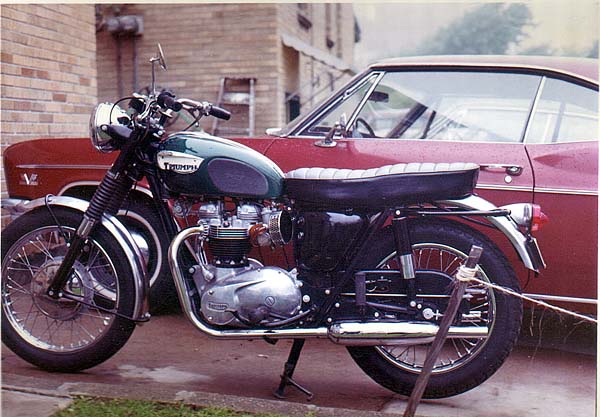

Couldn't resist. This pic of my 66 Bonneville (in front of my 66 Impala 427). Date: 1967

Just like the one that lured me to my evil ways. Thanks Paul
