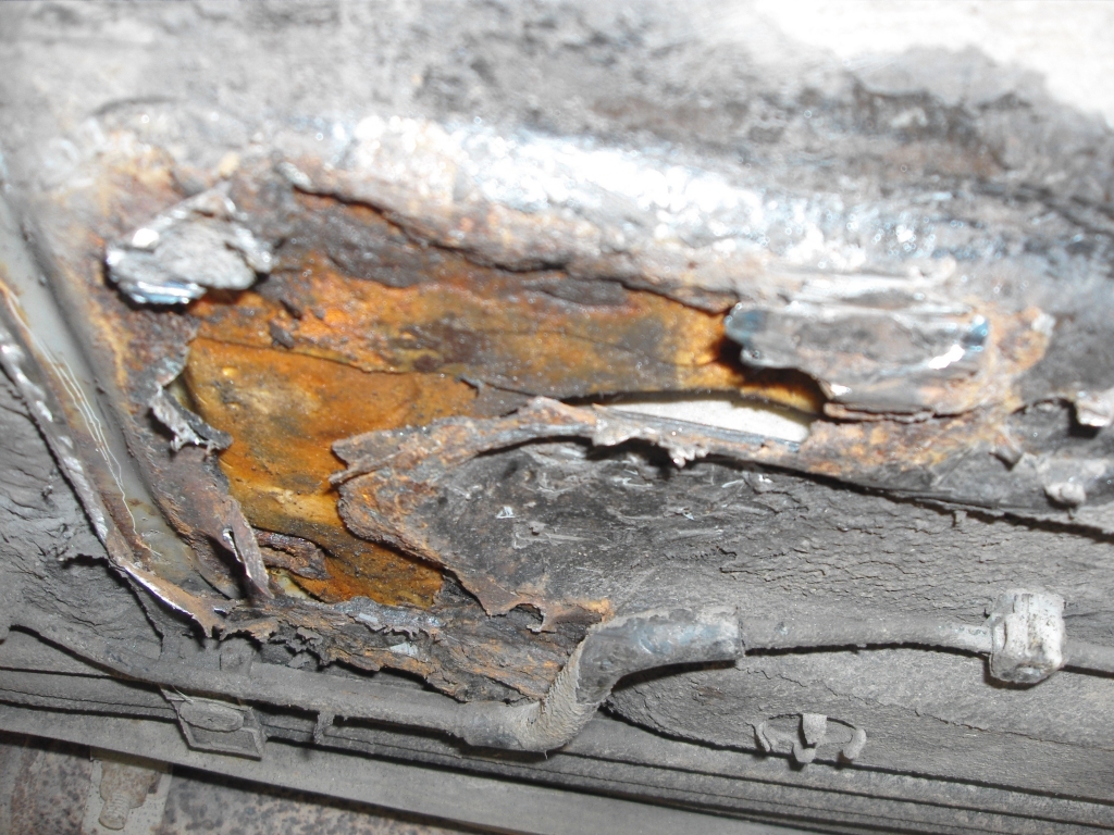

However - had another thorough look at the car today, and theres RUST.
I checked the reinforcing plates underneath the car, directly below both footwells - passenger plate is corroded, but OK. Drivers side plate rotting away, which prompted the seller and myself to have a look under the carpet. This is what we found:
Drivers footwell reinforcing plate
Drivers footwell, under carpet - moisture, and rust
How much would this cost to fix?!
I'm inclined to still go ahead and purchase if the fix isn't too dear - It's just north of 7k GBP, which is roughly where similar 4.2 XK8's are on UK Autotrader.
I've got a feeling the seller isn't going to budge on the price much, despite the rust. OK, it may not be an urgent fix - but still something I have to budget for in future.
Coolant problem was - it was a low coolant warning, not a temperature warning. It's been driven for 2 weeks (since being discharged with a clean bill of health from the local jaguar specialist garage) in stop start and motorway driving, and the coolant level hasn't budged. The seller suspects the garage didn't top up it fully on the last recent service... and I'm inclined to believe him. Pressure tested 3/4 times, all OK - no leaks under the car etc.

Repair panels are readily available in the UK - here :
Jaguar XK8 XKR Body Repair Panels Floor Pans | Jaguar XK8 and XKR Parts and Accessories
although if you search around a bit, you can find the same at better prices. PM me if you want more info. Allow £100.00 or so for welding plus your own, or paid for labour, to remove seats, carpet etc. Fairly common problem due to a stupid design fault with the original (XJS based I believe) floor pan.
Here's my floor :
Here's my floor :
