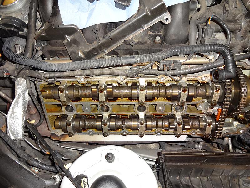

OK, all went well, you can see here where the oil was leaking out.
The head.
The problem area.
Also there were leaks round the spark plugs.
All well now.
