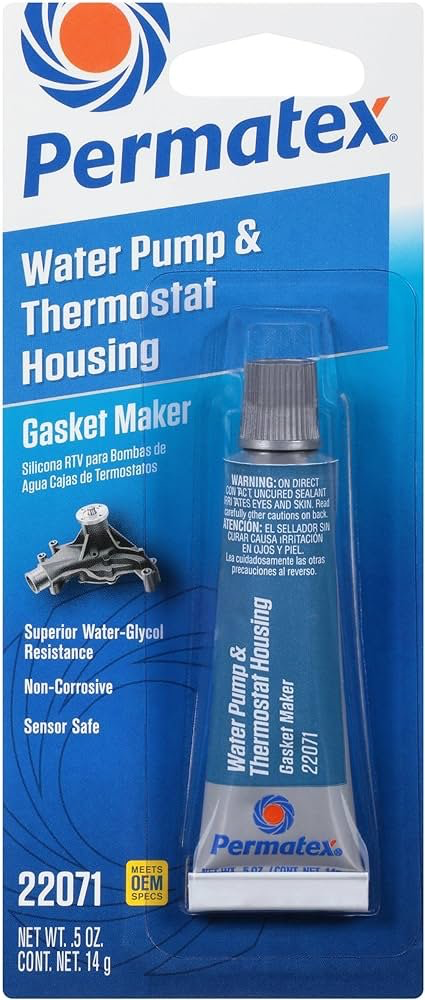

another vote for gaskets dry. The surfaces must be super clean. I use paint thinner on a white cloth. Keep rubbing at it until the cloth comes away still white. Let dry completely before placing gasket .
the best RTV I’ve used is this , the tube is small and pricey, but none better for use anywhere where RTV is called for, Not just around the water pump.
