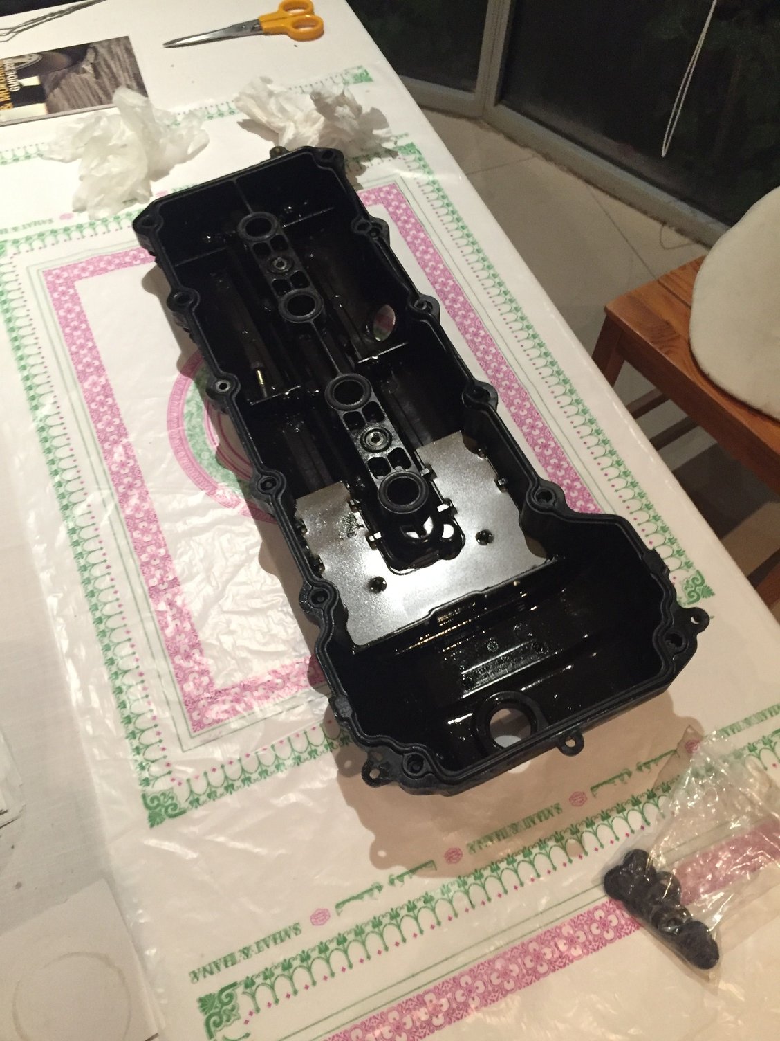

+1 to RJ237 to cleaning the Cam cover PCV mesh. Easy thing to remove and check. Zero dollar cost to check too. Pic below of what’s in the cover and be careful of the internal mesh cover as the fixings are brittle.
Do you have rough idle and or misfires? If not, a blocked PCV may not be the root cause as you only mention your car smokes after a long shut down period of time as the engine cools. Normally there would be other symptoms with a blocked PCV.
Burning oil in your case might be a case of piston troubles..... unfortunately

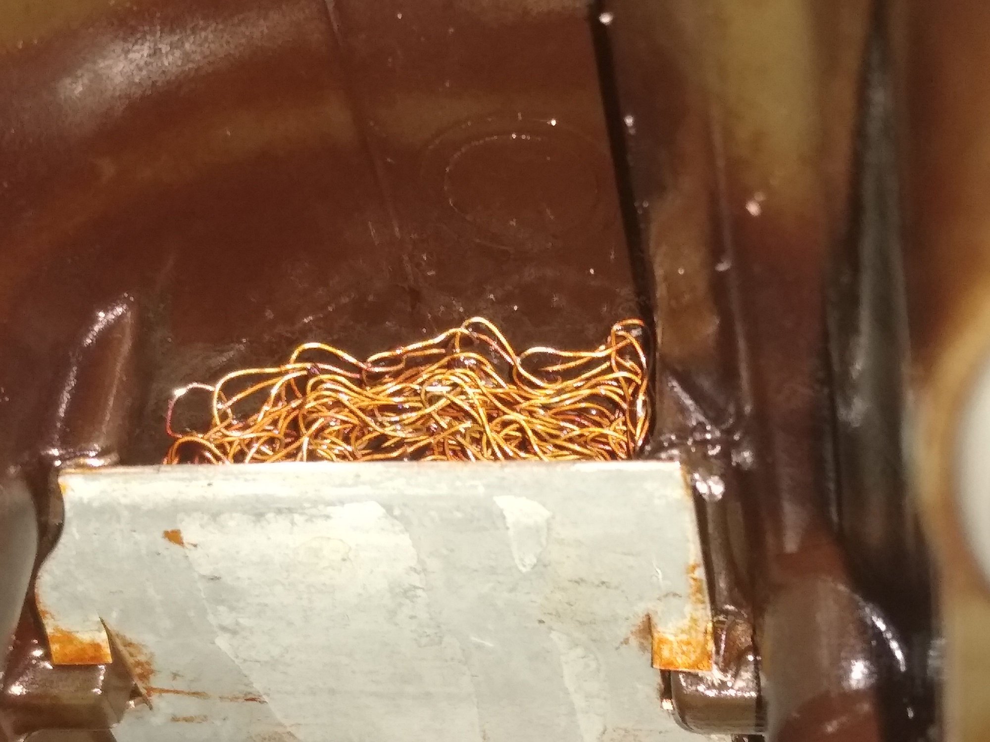

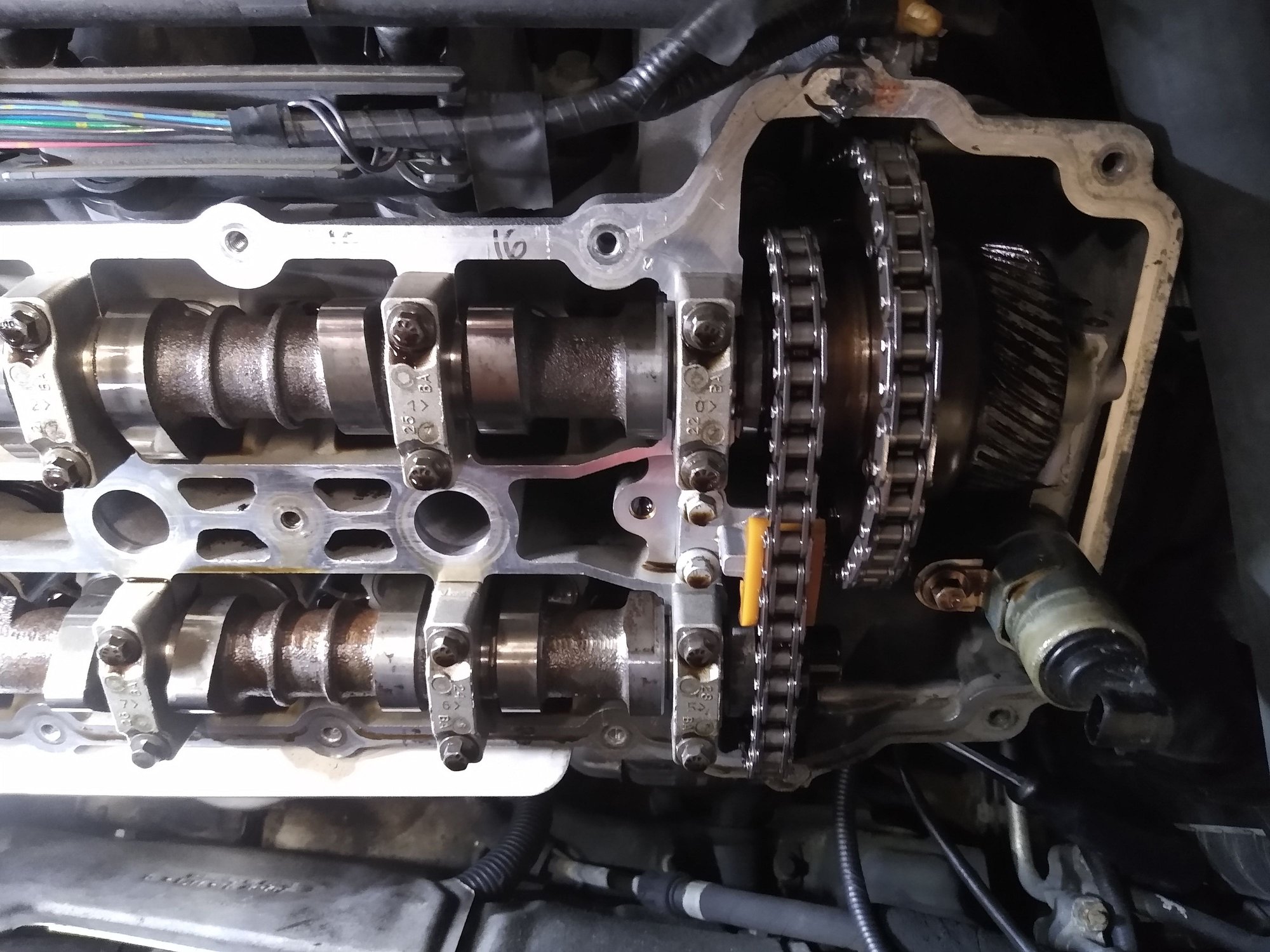

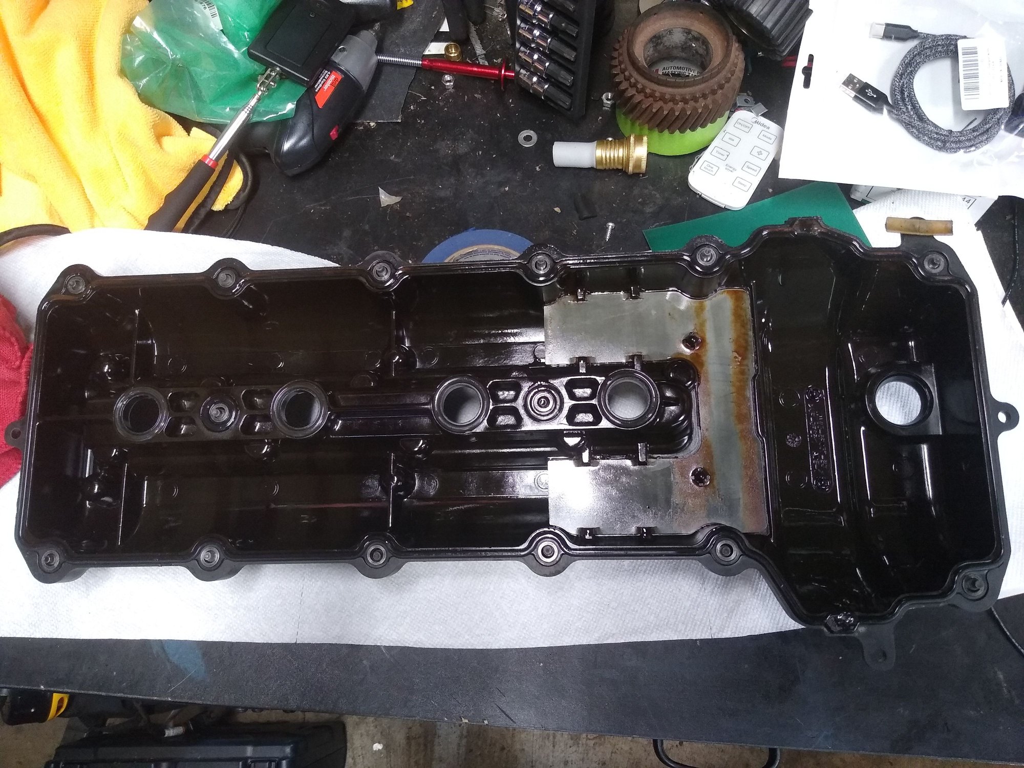

I pulled off the right cam cover this afternoon to see if I could find any gunk that may have blocked it up. The inside of the cam cover, the mesh and the engine seemed pretty clean overall (see photos). I'm working on the metal plate over the mesh so I should have some definitive information shortly. One thing I found interesting was the lack of oil residue in the vent from the cam cover and the plastic hose going to the air intake. I would have thought I would find an oil film there.
Old Oct 29, 2020 | 02:58 PM
max224's Avatar
Joined: Jul 2014
Posts: 1,000
Likes: 164
From: Lima, PA
I finally removed the cover from the filter mesh compartment in the cam cover and that the mesh, while a bit dirty was not sludged up enough to block the opening. I even took the mesh out and held it up to the light to confirm that it's porous. Kind of disappointed because I was hoping that I'd be on my way to rectifying the problem. Not sure if it's worth taking off the other cam cover, but will do it anyway. Oh well, time to clean the mesh and put the cam cover back on.
Oily and dirty, but not clogged.
