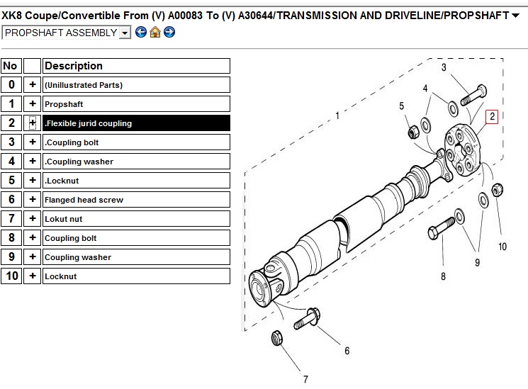

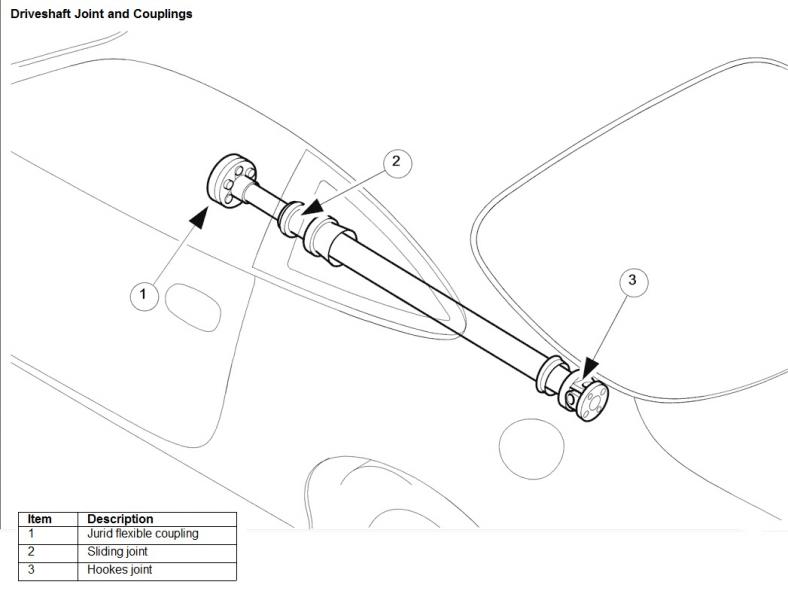

Originally Posted by test point
No real knowledge on your issue but there is a rubber coupling between the transmission and the drive shaft that almost universally has some level of deterioration..............
This rubber coupling (called a Jurid - item 2) has been a weakness since the XJ40 design.
Although the XK8 Jurid doesn't appear to suffer the same frequency of splits as the saloons, most do show wear with an accompanying loss of smoothness in the driveline.
Worth examining both the Jurid (item 1) and the Universal Joint (item 3) for wear and ensuring the securing bolts are all tight:

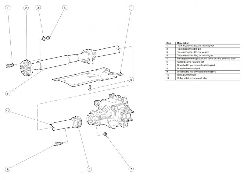

The later 4.2 models have a different design of propshaft with a centre bearing:
The front shaft is thinner (collapsible in the event of accident) which may put less stress on the Jurid and make it last longer.
