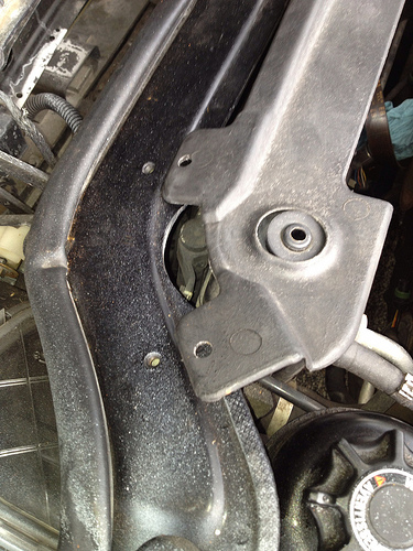

Anyone have a sketch of how the three radiator are placed in relation to one another? To the upper crossmember(??) where the cover plate that is over the radiator screws into.
My main rad looks to be too far back. Upper hose interfering with airbox.
