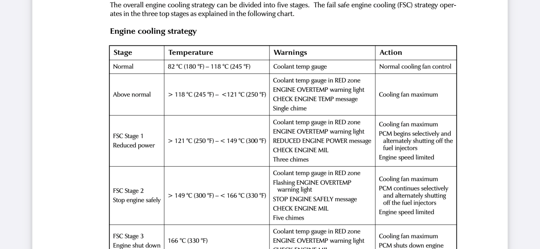

I’ve encountered numerous air pockets that needed to be purged, but never had some air in the cooling system cause severe overheating.
the motor has to get really hot to turn on the high temperature warning.
i can’t answer your question about the cooling fan. But I would never mix parts with an XK8 on my 2002 XKR. If there is a different part number for the XKR I bet there’s a good reason for it. Order the correct part and hope that will correct your issue.
Overheating on these cars can happen suddenly and the aluminum construction does not fare well if the temperature is too high.

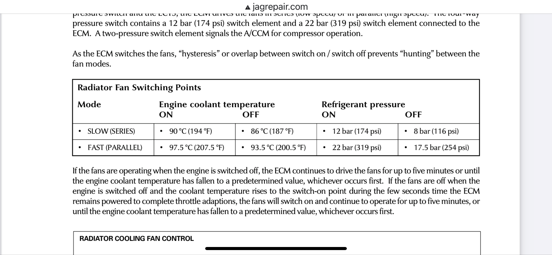

Fan speed probably not constant, controlled by ecu.

my fans on the 2002 XKR only have two speeds. Don’t know about the other years.
