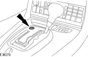

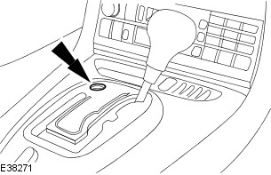

Remove the selector lever blanking screw.
Using a suitable tool, press and hold the brake shift interlock actuator manual override and simultaneously move the selector lever to the "N" position.- Remove the suitable tool.
Install the selector lever blanking screw.

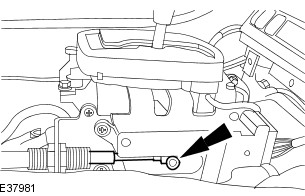

- Move the transmission selector lever to the "R" position.
- Remove the floor console.
For additional information, refer to Section 501-12 Instrument Panel and Console.
Detach the selector lever cable from the transmission selector lever linkage.
Detach the selector lever cable from the transmission selector lever bracket.- NOTE:
Fully extend the selector cable, then retract the selector cable one detent.
Make sure the selector lever cable is in the "R" position. - Make sure the transmission selector lever is in the "R" position.

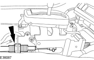

Attach the selector lever cable to the transmission selector lever bracket. - NOTE:
Make sure the selector cable and transmission selector lever have remained in the "R" position.
Attach the selector lever cable to the transmission selector lever linkage. - NOTE:

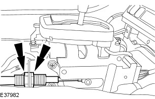

Adjust the selector lever cable adjustment nuts to lock against the retaining bracket.- Do not fully tighten the selector lever cable adjustment nuts.
- Make sure all transmission selector lever positions select the relevant automatic transmission states.
- NOTE:
When tightening the selector lever cable adjustment nuts, make sure both adjustment nuts are tightened to the specified torque simultaneously.
Tighten the selector lever cable adjustment nuts.- Tighten to 20 Nm.

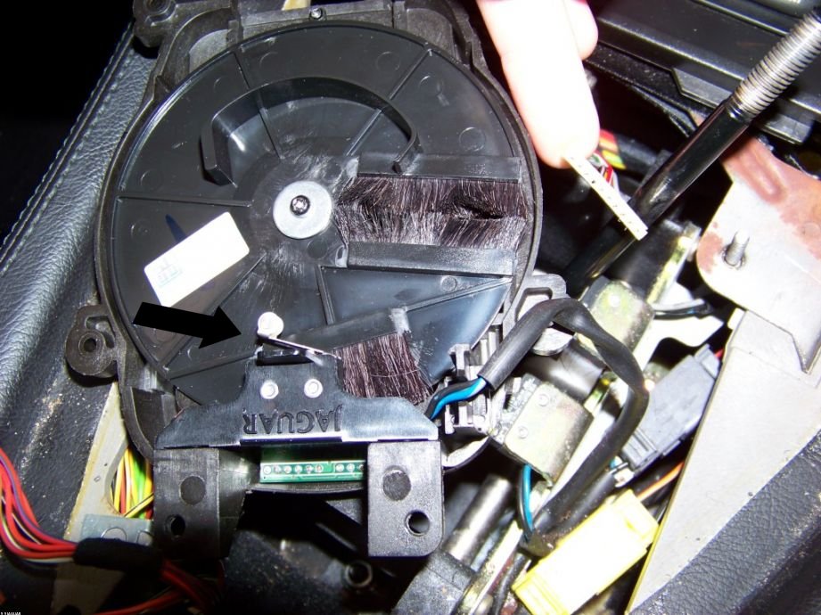

You know what I did to mine? It wouldn't let me put it in gear because the tab on the microswitch had fallen off. I couldn't find it. I ended up removing the gearshift interlock solenoid while I waited for a new tab to arrive in the mail.
Not sure about a 2006 car - mine's nearly 10 years older but ........... at the "P" and of my J Gate, there's another microswitch that is operated when the shift-lever is moved across the bottom of the 'J' from auto to manual as it were.
Not sure this picture is an XK8 J Gate, but it's fairly similar - black arrow points to the switch I refer to :

With a bit of fiddling got the three other junction boxes (white and yellow plus big white) apart on the left hand side and WD 40'ed them - they looked ok. Wiggled a few wires about.
No joy - worked fine for a bit <thought I'd cured it) but when shifted from 2nd to 5th gear alumination light went blinking again instead of steady, lost the S mode and no "manual" gears selected even though I can move the gear selector freely.
Any idea what next before I throw it over to the specialist Jag garage? I try to help myself before submiting to the garage.
I do wonder if there is a sensor issue as DSC is playing up too. Re-reading the above it could be the microswitch on the J Gate <DevonDave> as you move to "manual". I will try to work out how to access that tomorrow perhaps.
