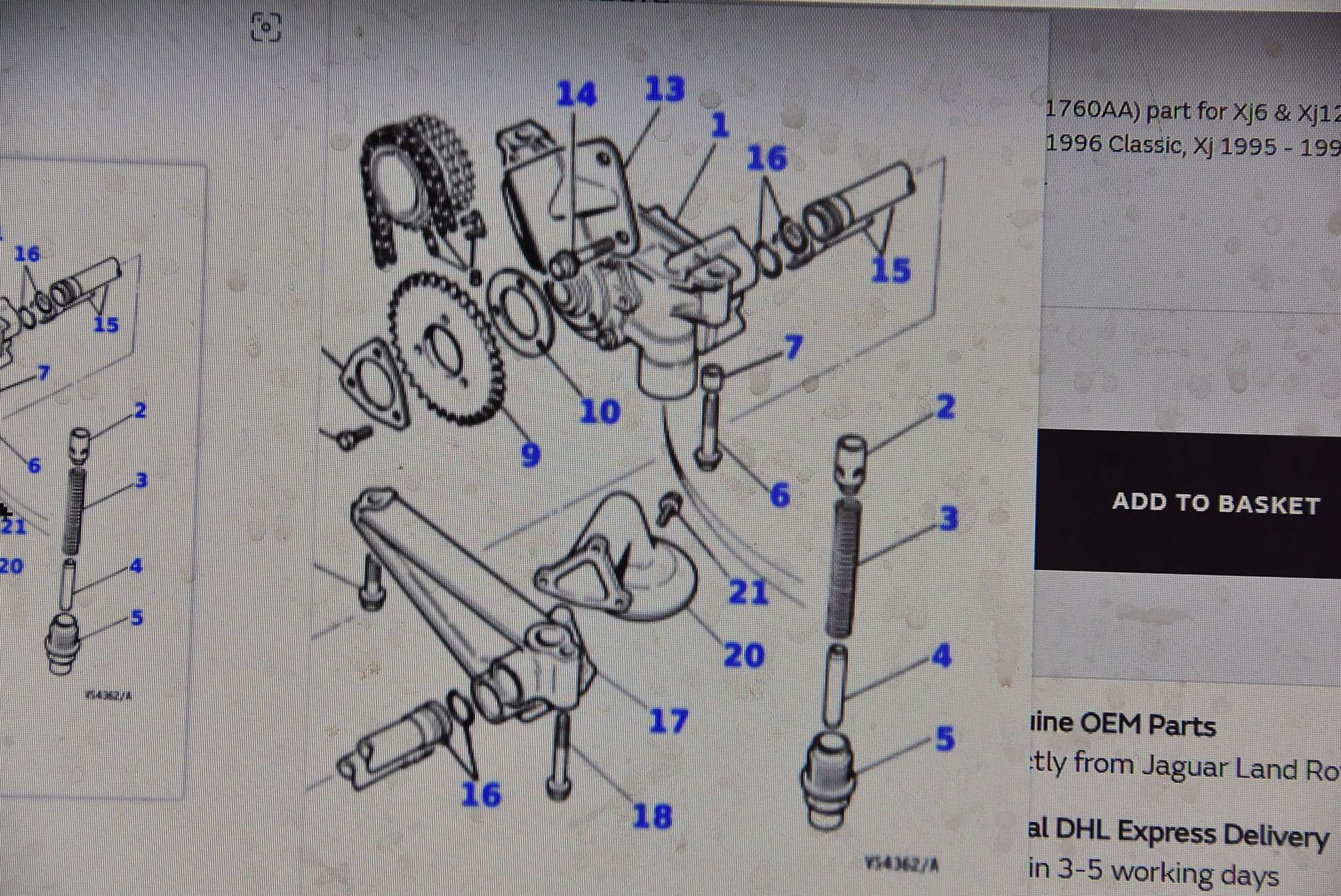

There is a pressure relief valve in the pump which opens when the oil pressure reaches what the makers feel is "normal".
Looking at the diagram its items 2/3/4/5.
Not sure if the bolt 5 is in the sump ,accessible when you take the pan off or external.
Second photo seems to say its external , the bottom line being the sump gasket but if you can get to the bolt in the tube bit sticking up is any ones guess.
If it gets blocked the the surplus oil cannot drain off..3 is a spring
