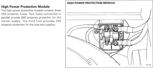

The high power protection module is behind the spare wheel in the boot - maybe there is a loose connection that needs tightening.
Yup - that's where I'd start too.
