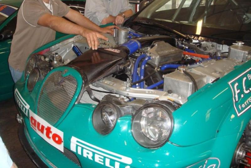

this is what i want for my XKR!

Originally Posted by steveinfrance
I presume you are joking?
I was not totally kidding! I know that the pictures are in the XKR with aluminum frame, but it could be a good idea to make a similar filter in carbon and have a bonnet cut to create the space needed, making a air dynamic as this....

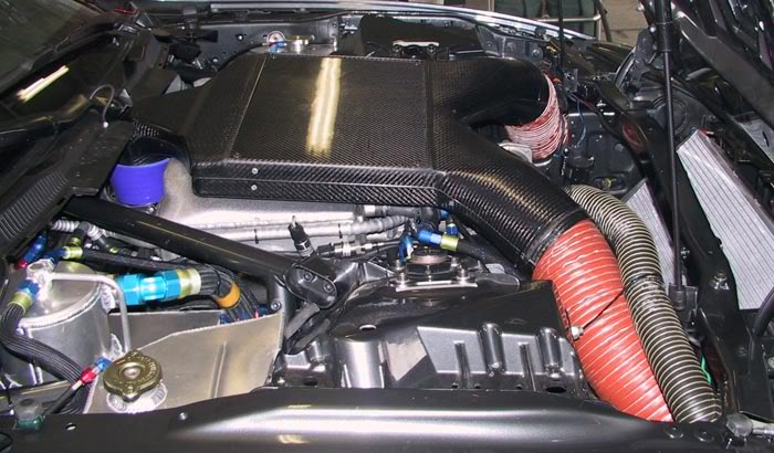

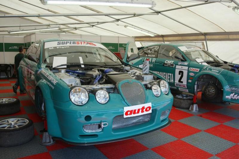

Old Jan 15, 2013 | 03:46 AM
User 070620's Avatar
Posts: 1,462
Likes: 304
the question I posed is that normally the suction tube passes over the exhaust manifolds by heating the inlet air to the engine. In addition, with a central air intake dynamic, we have a natural extra pressure in the compressor with the increase of speed.
is for this reason that the jaguar racing Ferlito using dynamic central air vents for their race s-type and XF cars!
I think there is a reason!
